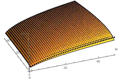

I computed $A(m,n)$ for $1\leq m,n\leq 50$ and imposed a power fit. I got $$A(m,n)\approx -0.0244157 +0.70197 (m+1)^{0.501309} (n+1)^{0.253279}$$This would seem to agree with our observations that $A(m,n)=O( m+1)^{1/2}$ for fixed $n$ and $A(m,n)=O(n+1)^{1/4}$ for fixed $m$. Here's a graph:
