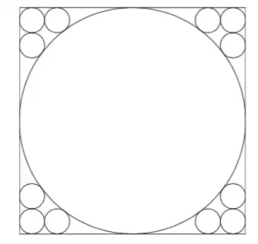

The diagram shows 12 small circles of radius 1 and a large circle, inside a square.
Each side of the square is a tangent to the large circle and four of the small circles.
Each small circle touches two other circles.
What is the length of each side of the square?

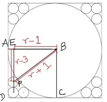

Join the center of the bigger circle (radius assumed to be $r$) to the mid-points of the square. It’s easy to see that $ABCD$ is a square as well. Now, join the center of the big circle to the center of one of the smaller circles ($P$). Then $BP=r+1$. Further, if we draw a vertical line through $P$, it intersects $AB$ at a point distant $r-1$ from $B$. Lastly, the perpendicular distance from $E$ to the bottom side of the square is equal to $AD=r$. Take away three radii to obtain $EP=r-3$. Using Pythagoras’ Theorem, $$(r-1)^2 +(r-3)^2 =(r+1)^2 \\ r^2-10r+9=0 \implies r=9,1$$, but clearly $r\ne 1$, and so the side of the square is $2r=18$.

    Presumably the $ r = 1 $ case corresponds to the corner circle, which is also tangent to the corner and the circle with centre $ P $. – Neil May 26 '20 at 15:41
    I'm an Engineer, not a Mathematician and this was the clearest solution to me. However AB being r-1 and BP being r+1 were clear, but I had to sit & puzzle for a while why AP = r-3. It might be worth showing or explaining. – Dragonel May 26 '20 at 18:14
    @Neil $r=1$ would correspond to a square of side length 6 filled with nine equal sized circles. – Kai May 26 '20 at 20:26
  • @Tavish - yes, that's clearer. Thx – Dragonel May 26 '20 at 21:42
    @Kai That's incorrect, no? The circle with radius r is supposed to be tangent to the square and the small circles. I think Neil is right here. – justhalf May 27 '20 at 09:41
  • @justhalf yeah I think you are correct actually, my mistake – Kai May 27 '20 at 13:40
    It's not actually $AP$ which is $r-3$, but $EP$, where $E$ is the intersection of $AB$ with the vertical line through $P$. – Nick Matteo May 27 '20 at 21:09

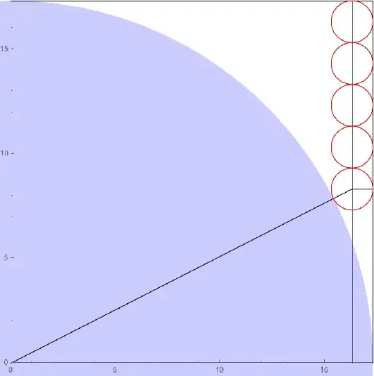

It is instructive to consider the general case. Suppose we have a circle of radius $r$ that is inscribed in a square of side length $2r$. Suppose $n$ tangent circles of unit radius can be drawn along the inside "corner" of the square. What is the relationship between $r$ and $n$? Your question is the case $n = 2$, the third circle drawn in the corner being redundant. The figure below illustrates the case $n = 5$:
The solution is straightforward. The right triangle shown in the diagram has legs $r-1$ and $r-(2n-1)$, and hypotenuse $r+1$. Therefore, $$(r-1)^2 + (r-2n+1)^2 = (r+1)^2,$$ from which it follows that $$r = (1 + \sqrt{2n})^2.$$ For $n = 2$, this gives $r = 9$ and the side length of the square is $18$. For $n = 5$, we have $r = 11 + 2 \sqrt{10}$. Whenever $n$ is twice a square, i.e. $n = 2m^2$ for a positive integer $m$, then $r = (1 + 2m)^2$ is also an integer and the circumscribing square has integer sides.
As a related but different question, given $n$ such circles, what is the total number of externally tangent unit circles that can be placed in the corner such that their centers form a square lattice and do not intersect the large circle? So for $n = 2$, this number is $f(n) = 3$ as shown in your figure. For $n = 5$, it is $f(5) = 12$.

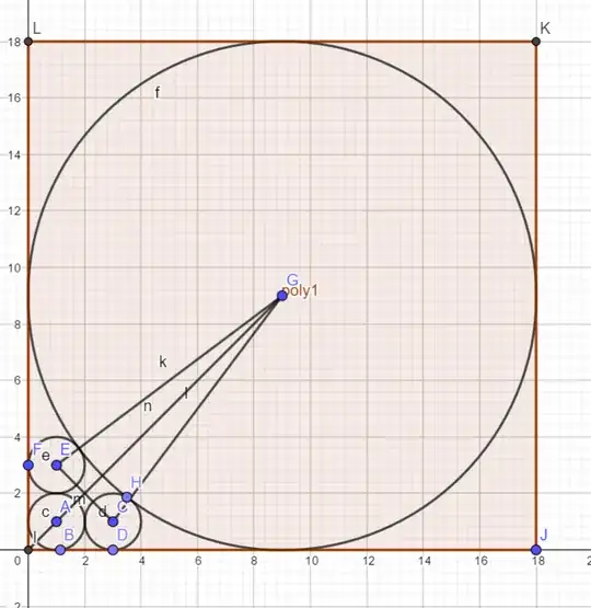

In the diagram below point $D$ is at $(3,1)$ and $E$ is at $(1,3)$ We have a right triangle using $G, D$ and the intersection of $GI$ and $DE$. Let the radius of the large circle be $r$, which is half the side of the square. Then $GD=r+1$, $D$ to the intersection is $\sqrt 2$ and $G$ to the intersection is $(r-2)\sqrt 2$ $$(r+1)^2=(\sqrt 2)^2+((r-2)\sqrt 2)^2\\ r^2+2r+1=2+2(r^2-4r+4)\\ 0=r^2-10r+9\\ r=1,9$$ and clearly $9$ is the root we want. The side of the square is $18$

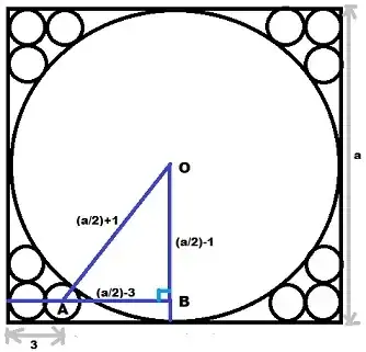

Let $a$ be the side of square. Join the center $O$ of largest circle to the center $A$ of small circle of radius $1$ (as shown in figure below)
$$AO=\frac{a}{2}+1, \ \ OB=\frac{a}{2}-1, \ \ AB=\frac{a}{2}-3$$ Using Pythagorean theorem in right $\Delta ABO$ $$\left(\frac{a}{2}+1\right)^2=\left(\frac{a}{2}-1\right)^2+\left(\frac{a}{2}-3\right)^2$$
$$a^2-20a+36=0$$ $$a=2,18$$ Since $a> 2$ hence, the side of square is $18$
