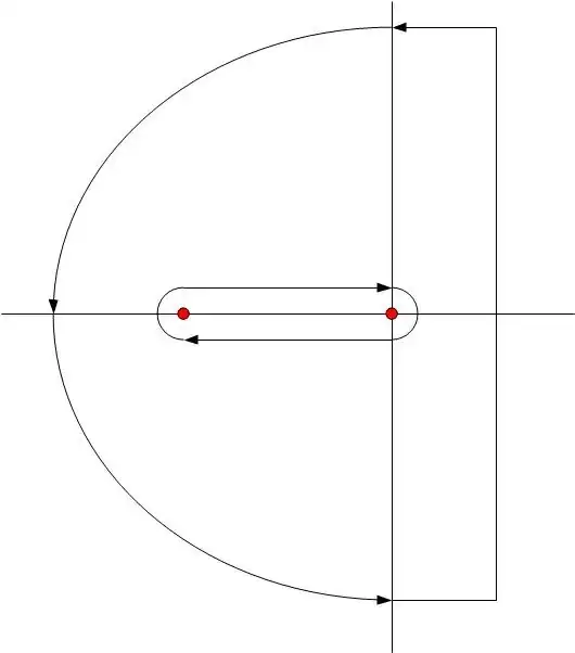

This one is interesting because of the presence of two branch points: one at $s=0$ and the other at $s=-r_0$. We will consider the complex integral
$$\oint_C ds \frac{e^{-a \sqrt{s (s+r_0)}}}{\sqrt{s (s+r_0)}} e^{s t}$$
where $C$ is the following contour pictured below:
2branch
This one's a bit odd because we are removing the branch point singularities by subtracting the inner contour $C_i$ from the outer contour $C_o$, i.e. $C=C_o+C_i$.
The integral about $C$ consists of the integral about vertical path (that ultimately becomes the ILT) and the integral about the outer arc. We expect that this latter integral vanishes as the radius of the arc gets larger; this only happens when $a \lt t$ as shown below, by letting $s=R e^{i \phi}$; this integral over this arc is, for large $R$:
$$\left| \int_{\pi/2}^{3 \pi/2} d\phi \,e^{R (t-a) \cos{\phi}} \right|$$
Note that $\cos{\phi} \lt 0$ over the integration region, so that the integral only vanishes for $a \lt t$ when the contour opens to the left.
This leaves the integral over $C_i$ which consists of integrals above and below the real axis, between the branch points, and integrals about small circular arcs about the branch points. These latter integrals vanish in the limit of the radii of the arcs going to zero. Thus, we are left with
$$\int_{c-i \infty}^{c+i \infty} ds \frac{e^{-a \sqrt{s (s+r_0)}}}{\sqrt{s (s+r_0)}} e^{s t} - \underbrace{i \int_0^{r_0} dx \frac{e^{i a \sqrt{x (r_0-x)}}}{\sqrt{x (r_0-x)}} e^{-x t}}_{s=e^{-i \pi} x} - \underbrace{i \int_0^{r_0} dx \frac{e^{-i a \sqrt{x (r_0-x)}}}{\sqrt{x (r_0-x)}} e^{-x t}}_{s=e^{i \pi} x} = 0$$
We set the sum of the integrals to zero because of Cauchy's theorem, i.e., there are no poles inside the contour $C$. The second integral is the integral over the line below the real axis; the third is the integral over the line above the real axis. Note that the phase transition was continuous from $-\pi$ to $\pi$ because we did not cross the branch cut; we did not see this explicitly because that information was included in the integrals about the branch points which vanished.

    @RandomVariable: the point of the inner contour is to subtract it out from the outer contour. We still have a connected region and, yes, the function is indeed analytic inside the (net) contour; that is, inside the outer contour, outside the inner contour. Note the direction in which the inner contour is taken (clockwise) versus the outer contour (counter-clockwise). – Ron Gordon Apr 23 '13 at 16:26

    My understanding of what you did is the following: The integrand $f(s)$ is analytic outside and on $C_{i}$. So if you integrate $f(s)$ around $C_{i}$ clockwise, it's equal to $2 \pi i \text{Res}[f(s),\infty]$. But $ 2 \pi i \text{Res}[f,\infty] = \int_{c-i \infty}^{c+i \infty} ds \frac{e^{-a \sqrt{s (s+r_0)}}}{\sqrt{s (s+r_0)}} e^{s t}$. – Random Variable Apr 23 '13 at 18:21
  • @RandomVariable: no, not quite. The crux is that the integral over the contour (the outer contour and the inner contour, in their respective directions) is zero. The integral over the vertical piece is the ILT; the rest is what we end up actually using. – Ron Gordon Apr 23 '13 at 18:23
