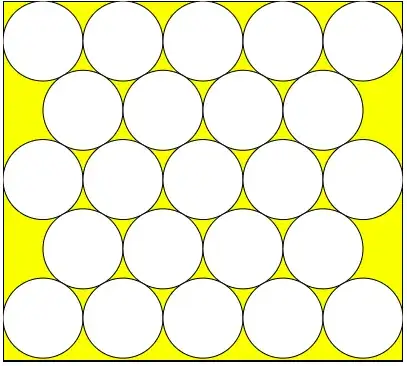

One method is to expand the box to $9 \times 10$ and fit circles of radius $1$. We can fit $23$ with:
But is it possible to fit more?

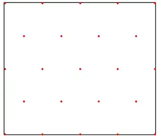

  • @RossMillikan Maybe something like https://int-e.eu/~bf3/tmp/21.png ? –  May 22 '20 at 14:29
You can do at least 23, since $7/4=1.75 > \sqrt{3}$:

Yes, in this example fitting 23 circles of radius=1 into an 9x10 rectangle is optimal.
This hexagonal packing arrangement plus the close cropped edges yields the highest packing efficiency for circles into a rectangle.
Packing efficiency for 23 circles = 23xPi/(9x10) = 80.3%
Packing efficiency for 24 circles = 24xPi/(9x10) = 83.7%
