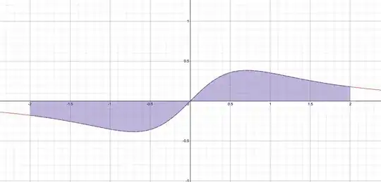

If you want to see a graphical way to see this,
Here it is clear how the algebraic sum of the areas is $0$.
Here you can play around with the graph to understand...Also try changing the function in it to another odd function (Desmos link)
NOTE: If you try to change the function in the linked graph, make sure to change it in every formula (including the inequalities)
