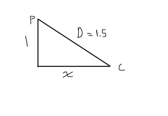

I'm going to explain how I solve it :
first I sketch this :
where $p$ is the plane and $c$ is the car.
We know the following things:
$\frac{dp}{dt} = 120 \ \ m.p.h,$
$\frac{dD}{dt} = -136 \ \ m.p.h,$
and using Pythagorean theorem we can find that $x = \frac{\sqrt{5}}{2} \approx 1.1 \ \ m$
And $\frac{dx}{dt} = \frac{dc}{dt} - \frac{dp}{dt}$ because there are two things which affect the distance x, the first one is the speed of the car (and the sign is positive because if the car is moving forward its speed should be positive and that should increase x and the opposite for the plane ).
Using Pythagorean theorem again we have:
$D^2 = x^2 + 1^2$. We take the derivative with respect to t so:
$\implies 2D\frac{dD}{dt} = 2x\frac{dx}{dt}$
$\implies (2)(1.5)(-136) = (2)(1.1)\frac{dx}{dt}$
$\implies \frac{dx}{dt} \approx -185.45 \ \ m.p.h.$
And we know that $\frac{dx}{dt} = \frac{dc}{dt} - \frac{dp}{dt}.$
So $ \ \ \implies \frac{dc}{dt} = -65.45 \ \ m.p.h.$
But the answer in the solution pdf is $65.45 \ \ m.p.h$
Can anyone tell where the wrong in my solution?
    Don't you mean $\frac{dp}{dt}=120\text{ mph}$? (instead of $\frac{dx}{dt}=120\text{ mph}$) – Isaac Ren May 16 '20 at 12:46
  • @IsaacRen fixed, sorry for that. – Kais Hasan May 16 '20 at 12:57
    Since the question is asking for how FAST the car is moving, there are asking for speed and not velocity. Notice that all the numbers they gave you were positive regardless of direction. So all you have to do is take the absolute value of your answer. – FafaDog May 16 '20 at 13:06
  • @BigBear I must say, that's an extremely unsatisfying answer, but it seems to be the right one xD – Isaac Ren May 16 '20 at 13:11
  • @BigBear actually in their short solution(which is the reason why I don't know where is my mistake) they assume that dD/dt = -136 m.p.h which the same in my solution so I think its not like that. – Kais Hasan May 16 '20 at 13:33
The car is travelling the wrong way down the freeway, so the speed is $65.45$ as MIT state (and they only ask for the speed), but the direction of the car is towards the aeroplane (because your maths looks valid to me), which I assume is unusual.
