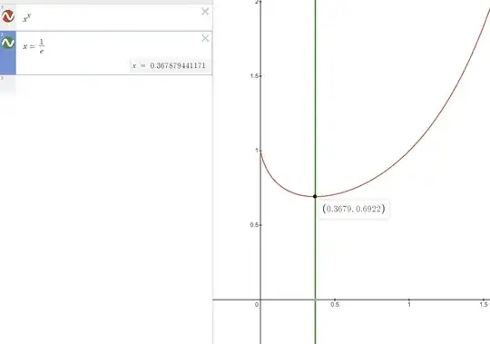

Illustrating your described pattern; future readers, please feel free to add accompanying observations.
In it, an educator demonstrates that going from $0.9^{0.9}, 0.8^{0.8}, 0.7^{0.7} ...0.1^{0.1}$ shows an odd pattern
what the hell is going on when we move from $0.367^{0.367}$ to $0.366^{0.366}$, where the downward trend turns upwards mysteriously
$$\frac{\mathrm d}{\mathrm dx} x^{x}=\frac{\mathrm d}{\mathrm dx} \left(e^{x\ln x}\right)=\left(x\left(\frac1x\right)+\ln x\right)e^{x\ln x}=(1+\ln x)x^x;\\\frac{\mathrm d}{\mathrm dx} x^{x}=0\iff x=\frac1e.$$
ryang
  • 44,428
