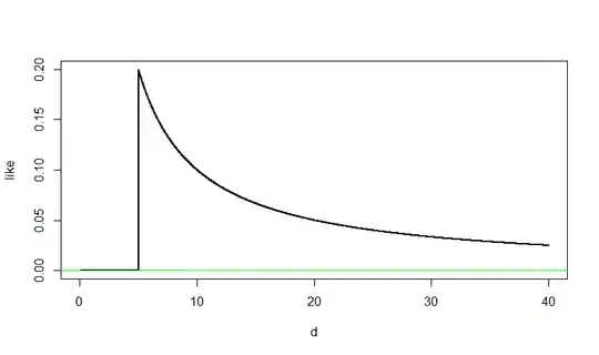

This is a case in which you have to find the maximum of the likelihood curve by logic, not by differentiation. (This often happens when the parameter of interest determines the interval of support of the distribution.)
Recall that the likelihood function is the density function viewed as a function of the parameter (here $d)$ for an observed value of the random variable (here $X = 25).$
The graph is made using R statistical software, where dunif is a uniform density function.
x = 25;  a = 20;  d = seq(.01, 40, by=0.01)
like = dunif(x, a, a+d)
plot(d, like, type="l", lwd=2)
abline(h = 0, col="green2")
Thus the MLE of $d$ is $X - a = 25 - 20 = 5.$
Note: The height of the likelihood function is maximized by making the interval of support of the distribution as short as possible.
