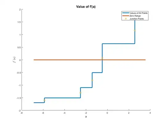

Defining $ f \left( a \right) = {\left\| a \boldsymbol{x} - \boldsymbol{y} \right\|}_{1} $ then $ {f}^{'} \left( a \right) = \sum {x}_{i} \operatorname{sign} \left( a {x}_{i} - {y}_{i} \right) $. By defining $ {s}_{i} \left( a \right) = \operatorname{sign} \left( a {x}_{i} - {y}_{i} \right) $ we can write $ {f}^{'} \left( a \right) = \boldsymbol{s}^{T} \left( a \right) \boldsymbol{x} $ which a linear function of $ \boldsymbol{x} $. Moreover, the function is piece wise constant with breaking points / junction points at $ a = \frac{ {y}_{i} }{ {x}_{i} } $.
Then there exist $ k $ such that $ \boldsymbol{s}^{T} \left( {a}_{k} - \epsilon \right) \boldsymbol{x} < 0 $ and $ \boldsymbol{s}^{T} \left( {a}_{k} + \epsilon \right) \boldsymbol{x} > 0 $ which is the minimizer of $ f \left( a \right) = {\left\| a \boldsymbol{x} - \boldsymbol{y} \right\|}_{1} $.
In the above figure one could see that each junction point has a vertical range associated with it. The optimal argument is the junction point which contains zero in its range.

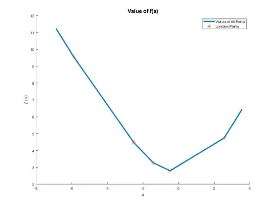

In the above figure one could see the value of the objective value. Indeed its minimum is attained on the junction point marked above.
I implemented both methods in MATLAB and verified the code vs. CVX. The MATLAB Code is accessible in my StackExchange Mathematics Q3674241 GitHub Repository.
