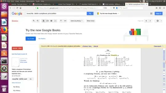

Wow. This is good. Given the wording in the question, with the lack of the expected factor 2 on the cosine, and the polynomial provided being reducible, I don't expect you are going to get anything from this OP other than demands to explain every little detail here. Which is why all I did was look up some items in an 1875 book. For comparison, see the 5 comments after this answer I did today: https://math.stackexchange.com/questions/3665626/group-isomorphism-question/3665641#3665641 – Will Jagy May 09 '20 at 00:46
more to the point, the primitive 15th roots of unity satisfy $$ \omega^8 - \omega^7 + \omega^5 - \omega^4 + \omega^3 - \omega + 1 = 0 $$ while $x =2 \cos \frac{2 \pi}{15},$ which can be written as one of the $x =\omega + \frac{1}{\omega},$ satisfies $$ x^4 - x^3 - 4 x^2 + 4 x + 1 = 0 $$
