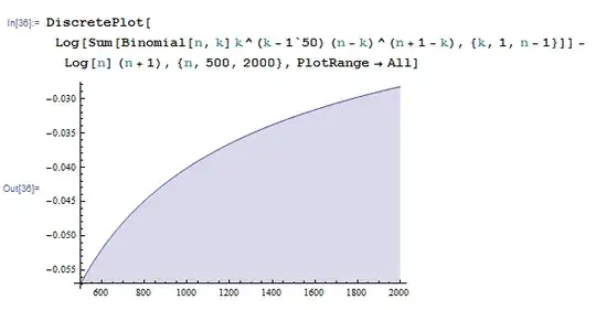

The upper summation bound can be lowered: $$ X_n = \sum_{k=1}^{n-1} \binom{n}{k} k^{k-1} \left(n-k\right)^{n+1-k} \stackrel{k =n-m}{=} \sum_{m=1}^{n-1} \binom{n}{m} m^{m+1} (n-m)^{n-1-m} $$ The latter representation shows that the ratio of $c_{n-k}/c_k$ is $\left(\frac{k}{n-k}\right)^2$ and is less than 1 for $2k < n$.
For a fixed $k$, and $n>k$: $$ \frac{1}{n^{n+1}} \binom{n}{k} k^{k-1} \left(n-k\right)^{n+1-k} = \mathrm{e}^{-k}\frac{k^{k-1}}{k!} \frac{n! e^{n}}{n^{n+1/2}} \frac{(n-k)^{n-k+1/2} }{(n-k)! \mathrm{e}^{n-k}} \sqrt{\frac{n-k}{n}} < \mathrm{e}^{-k}\frac{k^{k-1}}{k!} $$ Indeed, asymptotically: $$ \frac{n! e^{n}}{n^{n+1/2}} \frac{(n-k)^{n-k+1/2} }{(n-k)! \mathrm{e}^{n-k}} \sqrt{\frac{n-k}{n}} = 1 - \frac{k}{2n} - \frac{k(3k+1)}{12 n^2} + \mathcal{o}(n^{-2}) < 1 $$ Therefore: $$ X_n < n^{n+1} \sum_{k=1}^{n-1} \mathrm{e}^{-k}\frac{k^{k-1}}{k!} < n^{n+1} \sum_{k=1}^{\infty} \mathrm{e}^{-k}\frac{k^{k-1}}{k!} = n^{n+1} \left(-W\left(-\mathrm{e}^{-1}\right)\right) = n^{n+1} $$ where $W(x)$ is the Lambert's $W$-function, and we used $W(-\mathrm{e}^{-1})=-1$.

  • So I agree with the two most significant terms, but not the third term. I get $1/3$ and not the predicted $1$. – GEdgar Apr 19 '13 at 00:07
    This is a great answer and you are right about the $1/3$ as well (see http://en.wikipedia.org/wiki/Birthday_problem#Average_number_of_people ). Would you be able to apply the same type of reasoning (please) to http://math.stackexchange.com/questions/361452/asymptotics-of-sum-of-binomials where the current answer isn't quite right asymptotically I think. –  Apr 19 '13 at 07:49
