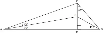

This problem is based on this Facebook post.
One can find the value of $x$ in this diagram
by noticing that $\angle CBD=50^{\large\circ}$, and therefore, $$ \frac{\tan\left(10^{\large\circ}\right)}{\tan\left(20^{\large\circ}\right)} =\frac{ED}{CD}=\frac{\tan(x)}{\tan\left(50^{\large\circ}\right)}\tag1 $$ Solving equation $(1)$ gives $$ \tan(x)=\frac{\tan\left(10^{\large\circ}\right)\tan\left(50^{\large\circ}\right)}{\tan\left(20^{\large\circ}\right)}\tag2 $$ Numerically computing the arctangent of the quantity in $(2)$ gives $x=30^{\large\circ}$. This surprised me; I had expected some odd angle, but apparently, this turns out to be a nice angle.
My question is: why does $\tan\left(30^{\large\circ}\right)=\frac{\tan\left(10^{\large\circ}\right)\tan\left(50^{\large\circ}\right)}{\tan\left(20^{\large\circ}\right)}$ ?
