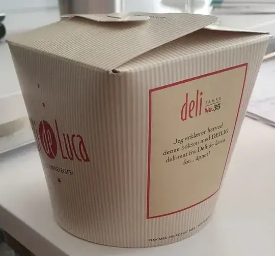

Having a bit of a problem calculating the volume of a take-away box:
I originally wanted to use integration to measure it by rotating around the x-axiz, but realised that when folded the top becomes a square, and the whole thing becomes rather irregular. Since it differs in circumference I won't be able to measure it like I planned.
Is there any method or formula that can be used to measure a shape like this, or do I just have to approximate a cylinder and approximate a box and add those two together?

    Fill it with water then measure the volume of said water? – Peter Foreman Apr 26 '20 at 17:29
  • 16
    @PeterForeman The easiest solution for sure, but sadly the point is to calculate it somehow, not just find it. – Nemui Apr 26 '20 at 17:31
    What a cool shape! – JonathanZ Apr 26 '20 at 19:11
    For ideas, look for "prismoid" or "prismatoid" ... https://en.wikipedia.org/wiki/Prismatoid – GEdgar Apr 27 '20 at 09:18
  • If you opened the lids, allowing the top edge to assume a circular shape, wouldn't the volume be simply that of a cone section? – yurez Apr 27 '20 at 14:24
    The industrial point of view : https://www.yorkshireprofiles.co.uk/square-to-round/ – Jean Marie Apr 27 '20 at 15:54
    If you open the lid and allow the cone to fall apart and assume a flat shape, wouldn't the volume simply be zero? Changing the shape to something different, without ensuring volume is kept equal, doesn't solve the problem. @yurez – Nij Apr 27 '20 at 20:08
  • Now who is going to make the master answer comparing the presented formulae? – Džuris Apr 27 '20 at 22:07
  • This shape looks like a conical frustum whose top has been cut up into 4 parts and the folding made the top look "squary". – GDGDJKJ Apr 28 '20 at 06:52
    A reasonable assumption that any answer should make is that the box is folded from flat cardboard (and glued to the bottom circle). Hence the surface of the object can only have a single axis of curvature at any point. – Joooeey Apr 28 '20 at 09:41
  • Find a cubical container. Fill your takeout box full of water. Pour the water into the cubical container. If the takeout box leaks, use fine sand instead. This workaround goes back at least to Thomas Edison. – Howard Miller Apr 28 '20 at 14:50

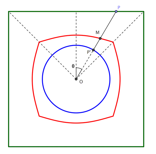

As the shape of the solid is not clearly defined, I'll make the simplest assumption: lateral surface is made of lines, connecting every point $P$ of square base to the point $P'$ of circular base with the same longitude $\theta$ (see figure below).
In that case, if $r$ is the radius of the circular base, $2a$ the side of the square base, $h$ the distance between bases, a section of the solid at height $x$ (red line in the figure) is formed by points $M$ having a radial distance $OM=\rho(\theta)$ from the axis of the solid given by: $$ \rho(\theta)={a\over\cos\theta}{x\over h}+r\left(1-{x\over h}\right), \quad\text{for}\quad -{\pi\over4}\le\theta\le{\pi\over4}. $$ A quarter of the solid has then a volume given by: $$ {V\over4}=\int_0^h\int_{-\pi/4}^{\pi/4}\int_0^{\rho(\theta)}r\,dr\,d\theta\,dx= \frac{h}{12} \left(4 a^2+\pi r^2 + 2ar \ln{\sqrt2+1\over\sqrt2-1}\right). $$
    Oh wow, thank you for the elaborate and easy-to-follow answer. Do you mind elaborating a bit more on how the different factors/operations done in your first equation gives us ρ(θ)? – Nemui Apr 26 '20 at 21:29
    Would then be interesting to compare the volume obtained this way with an empirically measured volume by Archimedes' method and see how good it is (what percent error there is). – The_Sympathizer Apr 27 '20 at 04:31
    @Nemui It's a linear interpolation: $M=(1-t)P+t P'$ and then, by similitude: $$t={PM\over PP'}={x\over h}.$$ – Intelligenti pauca Apr 27 '20 at 06:44
    The surface in question is obviously one with zero curvature everywhere. Does yours satisfy that? – user21820 Apr 27 '20 at 08:46
    My surface doesn't have zero curvature. If you want a surface without curvature (and smoother than mine) you can consider AlienAtSystem's answer. – Intelligenti pauca Apr 27 '20 at 09:44

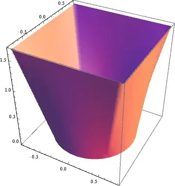

One can of course try to model the takeaway box as an appropriately constructed surface, and then compute a volume integral based on that.
My surface synthesis proposal uses this polar equation for a regular polygon (specialized to the square case) as a component, and I model the construction of the takeaway box as a linear interpolation between a circle of radius $r$ and a square with side length $2a$, and $h$ is the height of the box. The parametric equations can the be expressed as (written out in vector form to emphasize the components):
$$(1-v)\begin{pmatrix}r\cos\theta\\r\sin\theta\\0\end{pmatrix}+v\begin{pmatrix}a\varrho(\theta)\cos\theta\\a\varrho(\theta)\sin\theta\\h\end{pmatrix}\qquad 0 \le \theta \le 2\pi,\;0<v<1$$
where $\varrho(\theta)=\sec\left(\theta-\dfrac{\pi}{2}\left\lfloor\dfrac{2\theta}{\pi}+\dfrac12\right\rfloor\right)$.
Here is a plot of the surface using Mathematica:
With[{r = 2/3, a = 4/5, h = 5/3},
     ParametricPlot3D[(1 - v) {r Cos[t], r Sin[t], 0} +
                      v {a Sec[Mod[t + π/4, π/2] - π/4] Cos[t],
                         a Sec[Mod[t + π/4, π/2] - π/4] Sin[t], h},
                      {t, -π, π}, {v, 0, 1}, Exclusions -> None,
                      Mesh -> None, PlotPoints -> 35, PlotRange -> All]]
the box
The volume enclosed by this surface can be shown to be equal to
$$V=\frac{h}{6}\left(\pi r^2+4a\left(a+r\log\left(3+\sqrt{8}\right)\right)\right)$$
This surface isn't a perfect model, however. If you compare this surface with the box in the OP's picture, you'll notice that the transition from circle to square is a little more abrupt. One could try using a different transition to ease the edges in the box, but I'll leave the experimentation to someone else.

Plugging this into the volume formula gives:
$$V_{min} = h\left(\frac{1}{3}\pi r^2 + \frac{\sqrt{2}}{3} a r + \frac{1}{3}a^2\right)$$
With therefore a minimal $\gamma$ of $\frac{\sqrt{2}}{3}$ and a maximal $\gamma$ of $\frac{2}{3}$, we can ask the question:
How much does choosing the model then actually matter?
By taking a "cube" box as example with $h = 1$, $a=1$ and $r=\frac{1}{2}$, we can calculate the volumes and their differences:
$$\Delta V = V_{max} - V_{min} = \left(\frac{1}{12}\pi + \frac{2}{3}\right) - \left(\frac{1}{12}\pi + \frac{1}{3\sqrt{2}} + \frac{1}{3}\right) = \frac{2-\sqrt{2}}{6}$$
Or, in floating point units:
$$V_{max} \approx 0.928466$$ $$V_{min} \approx 0.830835$$ $$\Delta V \approx 0.097631$$
Or in other words, the choice of exact model changes the result in volume by at most 10%.
There is technically a "best" model among all possible choices of prismatoids, which is the one whose lateral surface is unrolled into the closest approximation of a circle ring sector, which is the lateral net of a truncated cone, the shape of the takeaway box before the top is folded, and a deformation of the paper which does not tear it has to preserve the net. However, I will not attempt to find which $\gamma$ this then results in, and only, based on the shapes of the models examined already, assume it is rather close to $\frac{2}{3}$.
    To see that your nomination is indeed the minimum: the "non-twisted" symmetry assumption implies the 4 square vertices and 4 square edge midpoints must be connected to the respective 8 closest points on the circle base. Therefore what remains to decide is, for any given one of the 8 sections, how to connect up that half-edge of the square to that 1/8th-circle arc, with straight lines. To see that your other answer is the maximum, just notice that it contains all other possible solutions; likewise, to see that this answer is minimum, notice that it's contained in all other possible solutions. – Don Hatch Apr 30 '20 at 05:20
