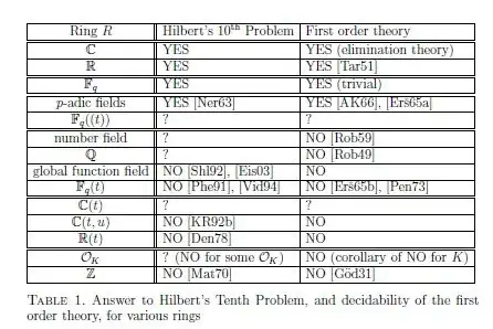

Intuition may be misleading here. In fact transcendental cases are often much easier than the integer Diophantine case. For example below is a table listing the known decidability results in various rings for Hilbert's tenth problem and the full first order theory, excerpted from Bjorn Poonen's interesting paper Hilbert's tenth problem over rings of number-theoretic interest
