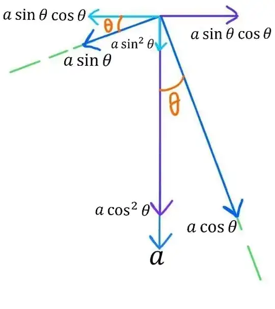

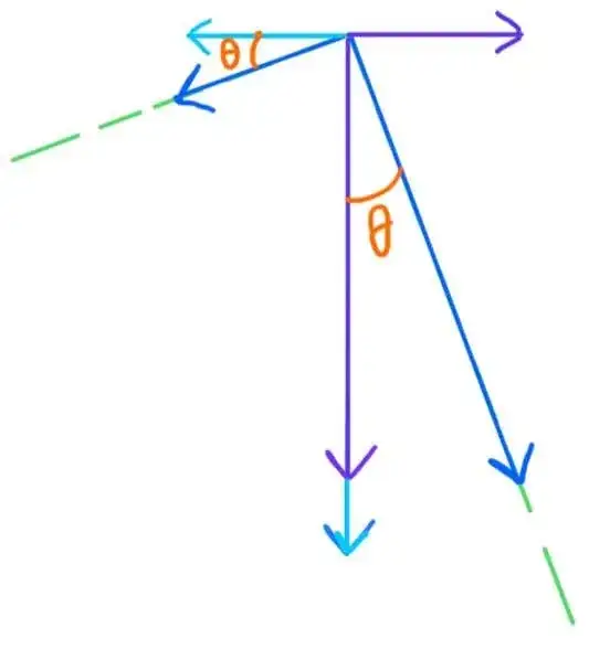

Proof using vectors:
Consider a vector of magnitude $a$ inclined at an angle $\theta$ to one line of a set of perpendicular lines.
Equating the components of the vector in the direction of the original vector, $$a=a\sin^2\theta+a\cos^2\theta$$ $$\implies\sin^2\theta+\cos^2\theta=1$$
This can also be seen visually by superposition:
