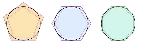

    The one dimensional analog of your question is: what does it mean to talk about the perimeter of a circle? Can you see how constructing a parameterization of a straight line (in the colloquial sense) to a circle allows us to make sense of it? Can you adapt this to a sphere? – Derek Allums Apr 24 '20 at 08:09
    @DerekAllums actually, the perimeter of a circle was taught to me as "consider a piece of string, that you curl around the outside of a circle. what is the length of that piece of string?" and that satisfied me. it fit well into the precise idea of measuring a 1D line on a ruler. but sadly, i can't adapt this to a sphere; a piece of string can be wrapped along a circle; but no piece of flat paper (or plastic, or whatever) can be "wrapped around" a sphere! – silph Apr 24 '20 at 08:34
  • @silph But think about it further and it's the same issue: if you believe you can approximate a curved line by bending a straight one, why not approximate a curved surface by bending a flat one? Better explanations of this intuition are below in other users' answers. – Derek Allums Apr 24 '20 at 08:48
  • 11
    @DerekAllums The difference is that the cut string is not an approximation; when you pull it taught, you get a straight line and you can measure it. But cutting up a sphere always approximates, and the number of pieces governs the accuracy of the approximation. That leads to the need for calculating the limit (i.e. calculus). – Barmar Apr 24 '20 at 16:11

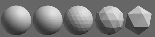

P.S. For a visualization of this approximation, you can search online for sphere parametrization, or simply think of a football (soccer ball).
Update 1: Thanks to Leander, we have a visualization:
visual representation of the patches
One might notice that this visualization is slightly different from cutting up a sphere; it takes sample points on the sphere and attach triangles to these sample points. I want to remark that there is no essential difference between this and my method. The idea is the same: approximation.

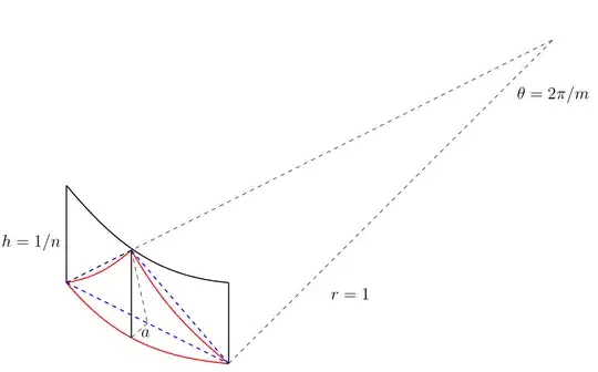

Update 2: A comment (by Tanner Swett) mention that the method of using a polygon mesh may be flawed. Indeed, the example of Schwarz lantern shows that some pathological choice of the polygon mesh may produce a limit different from the surface area. The following explanation should be helpful:
As I have mentioned in step 2 above, if we are not careful with how we approximate the areas of the patches, the approximation may not work. The Schwarz lantern is an example where a careful choice of the approximating triangles can lead to the following result: Suppose $T$ is a triangle we use to approximate a patch $P$, then it is possible ${\rm Area}(T)/{\rm Area}(P)\to a\neq1$. To illustrate this, consider a single triangle on the Schwarz lantern: schlant
We assume the cyclinder has total height $1$ and radius $1$. We take $n+1$ axial slices, and on each slice $m$ points. The area enclosed by the red curves is a patch on the cylinder, and the triangle enclosed by the blue dashed lines is the one used to approximate the patch. Let $P$ and $T$ denote the patch and the triangle respectively. We see that the bottom edge of $P$ and $T$ has ratio $1$ as $m\to\infty$. What really makes a difference is the ratio of their heights. Suppose along the vertical direction the height of $P$ is $$h=1/n$$ Then the height of the triangle is $$h_T=\sqrt{1/n^2+a^2}$$ By a simple computation we know $a=1-\cos(\pi/m)\approx(\pi^2/m^2)/2$. Therefore, $$h_T/h=\sqrt{1+\frac{\pi^4n^2}{m^4}}$$ If $n$ has higher order than $m^2$, then the limit is bigger than $1$, and consequently ${\rm Area}(T)/{\rm Area}(P)\not\to1$.
This problem would have a smaller probability of occurring in practice. Imagine if you do cut the cyclinder into patches, you'd use $h$ instead of $h_T$ to estimate the area. But again, it is hard to make this (what approximation is acceptable) precise without using the language of calculus.

    I forgot to mention that this method suffers from the Schwarz lantern problem. Even if you approximate the sphere using only triangles whose vertices lie on the sphere, no matter how small an upper bound you place on the size of the triangles, it's possible for the triangles to have an arbitrarily large surface area. So as much as "value of the approximation above should tend to a fixed number", it doesn't tend to a fixed number. (But the desired number is probably the limit inferior.) – Sophie Swett Apr 26 '20 at 03:55
  • @TannerSwett Thanks for mentioning this interesting example. But I don't think ithe desired number is the limit inferior, since the limit may exist, but fail to be the desired number. And when a limit exists, limit = limit inferior. – trisct Apr 26 '20 at 06:28

  • Perhaps, imagine a collection of hexagons and pentagons, arranged in a sort of geodesic configuration instead. the area of each of these can easily be calculated, and can also get progressively smaller. Or, measure the triangles between the rows as separate items. I imagine you could imagine the rest... Or just use triangles! – MrWonderful Apr 24 '20 at 21:47
  • @TonyK That's a good point. In fact to fill the surface of a sphere as per CCTO's suggestion you need two types of tile: round ones and complementary-round ones. Squares wouldn't do the trick at all. Even with round ones you would have to decide how to position them relative to one another: there is no positioning pattern (e.g. vaguely hexagonal) that is "natural" or "ideal", and I think only some numbers would work at all. Plus, taking a simple example, with a 12 points evenly distributed throughout the sphere's surface, the "complementary" shapes would actually take up a lot of area. – mike rodent Apr 26 '20 at 13:58
  • @TonyK The error will be in the same order of magnitude as the one introduced by the fact that you can emphatically not tile any part of the Earth with flat, rectangular tiles. In other words, the error will be just as negligible if the tiles are small enough. Your particular error can also easily be avoided by making the width of the tiles the proper fraction of the respective latitude length -- the concept here does not really depend on all tiles being evenly sized. – Peter - Reinstate Monica Apr 27 '20 at 13:24
  • @Peter: I agree entirely. See my second comment. – TonyK Apr 27 '20 at 13:53

I would first introduce approximating the area of a shape and pi via the method of exhaustion
Exhaustion of a Circle - Wikipedia
The area or circumference is approximately the average of the two, but not quite..
Once students understand this for a two-dimensional shape, it should seem clear both
  • pi exists and is a transcendental number
  • it is illogical to try and represent the area or circumference of a circle without it
With this out of the way, you could pose using Exhaustion with an N-faceted polygon (perhaps beginning with a cube inside a cube?). Ideally this will lead them to discover again that they will need pi to find the true surface area, while also subtly preparing them for calculus.
Plausibly you could purchase or fashion an object to show this, but I suspect some graphics simulation software will aid you (and also trivialize discovering the area of the contained and surrounding solids)
ti7
  • 239
    This strategy works well to describe a circle's circumference (though I rather doubt that it makes clear that $\pi$ is transcendental), but I'm not convinced it's a viable strategy for surface areas in any higher dimensions. The method of exhaustion makes explicit use of the existence of infinitely many regular polygons, and the higher dimensional analog is resoundingly false-- there are only finitely many regular polytopes in every dimension $n>2$. That isn't to say the method can't salvaged, but you quickly lose the intuitive appeal when invoking non-regular approximating polytopes. – jawheele Apr 25 '20 at 20:26
    Beyond that objection, I also feel this isn't a good approach to defining area (the OP's interest), the reason being that the intuitive feel of this picture is precisely the same as that of this well-known false proof that $\pi=4$: https://math.stackexchange.com/questions/12906/the-staircase-paradox-or-why-pi-ne4 (the same method can start with an inscribed square and seem to demonstrate $\pi = 2 \sqrt{2}$). If one's only conception of the definition of circumference came from this picture, you'd be hopeless in discerning why your picture works and the false proof above doesn't. – jawheele Apr 25 '20 at 20:37
  • Erratum: I believe I spoke too quickly when claiming that starting with an inscribed square can seem to demonstrate $\pi = 2 \sqrt{2}$, though the objections still stand. – jawheele Apr 27 '20 at 19:19

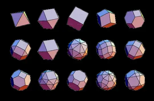

Consider a "convex polyhedron":
You can start with a simple pyramid or cube, but, as the polyhedron gets more and more complex, it can be made more and more like a sphere. At each step along the way you can measure the dimensions of each flat surface, add the surface areas together, and come up with an estimate of the surface area of the equivalent sphere. As the polyhedron is made with more and more pieces, it becomes a closer approximation to the sphere.
There is this mathematical concept known as a "limit" where the approximation, after an infinite number of refinements, essentially becomes a sphere, and the sphere's surface area is determined.
If the surface area of a sphere is $1\text{cm}^2$, that means that if you cut a sphere into very very very tiny pieces, so tiny they are almost perfectly flat, then the total area of those pieces will be very very very close to $1\text{cm}^2$.
5xum
  • 126,227
  • 135
  • 211
    And, moreover, the tinier (and thus flatter) you make the pieces, the closer the area would be to $1$ square centimeter. – PrincessEev Apr 24 '20 at 06:51
