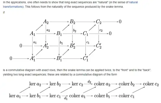

An important part of the snake lemma is the naturality of the ker-coker sequence produced by it. However, no source seems to state or prove this part for arbitrary abelian categories. However, it is needed, for example, to product long exact homology sequence.
Wikipedia claims the following:
I would like to understand a proof of this fact without using Freyd-Mitchell embedding.
Edit: this is different from existing questions, since my question concerns naturality of the ker-coker sequences, which the other questions do not adress.
