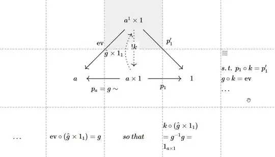

I have already proven that $a \times 1 \simeq 1 \times a \simeq a$ given a terminal object $1$ of a cartesian closed category $C$ (CCC). By CCC I mean that $C$ is finitely complete and has exponentiation (accordingly with Goldblatt's Topoi).
If you take the product's universal diagram for $a \times 1$ so that one of the triangular sides is actually the exponential diagram we're after, then you have the following.
Product and Exponential diagram in a CCC Drawn with: https://tikzcd.yichuanshen.de/.
As you can see I've done one direction of the isomorphism in the picture. How do I show that $(\hat{g} \times 1_1) \circ k = 1_{a^1 \times 1}$ though? The confusion comes from not being sure where the product map $\hat{g} \times 1_1$ comes from because if I did then I'd have the two projector arrows $p,q$ and then $\hat{g} \times 1_1 = \langle \hat{g} \circ p, 1_1 \circ q \rangle = $ the product map for object ?
I would like to complete the proof as is, so no appeals to Yoneda's lemma are allowed here.

For one direction, we will use the counit $\varepsilon$, which you're calling $\text{ev}$. We can use this to get a map (which you rightfully found):
$$ a^1 \xrightarrow{~\sim~} a^1 \times 1 \xrightarrow{~\varepsilon~} a $$
As is often the case in category theory, if we got half an iso using some construction, we should try to get the other half using the dual of that construction. So let's consult the (much less appreciated) unit $\eta$ of the adjunction. This gives us a map:
$$ a \xrightarrow{~\eta~} (a \times 1)^1 \xrightarrow{~\sim~} a^1 $$
I leave it to you to check that these are mutually inverse, and that the obvious iso from $(a \times 1)^1 \cong a^1$ is actually an iso.
