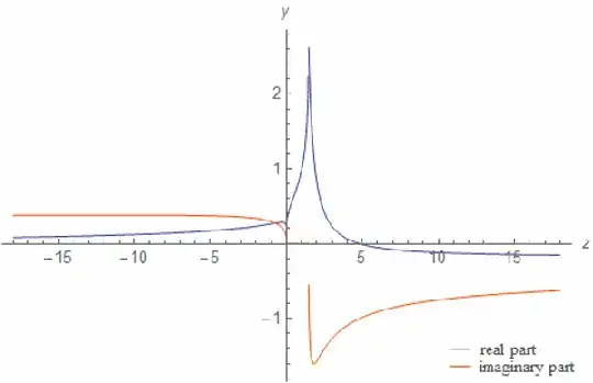

The infinite power tower or infinite tetration ${\displaystyle z^{z^{z^{\cdot ^{\cdot ^{\cdot }}}}}\!}$ can be extended to complex numbers or to the complex plane. This infinite power tower has the general value
${\displaystyle h(z)={\frac {W(-\ln(z))}{-\ln(z)}}} \quad (1), \tag*{}$
where $\ln(z)$ is the principal branch of the complex logarithmic function, and $W(u)$ is the Lambert W function or the product log function, defined as:
${\displaystyle u = y e^y \Leftrightarrow y = W(u).} \tag*{}$
For additional clarification, here is the proof of the relation $(1)$ above:
Let ${\displaystyle z^{h}=h} \tag*{}$ Then ${\displaystyle z=h^{1/h}} \tag*{}$ ${\displaystyle z^{-1}=h^{-1/h}} \tag*{}$ ${\displaystyle {\frac {1}{z}}=\left({\frac {1}{h}}\right)^{1/h}} \tag*{}$ ${\displaystyle -\ln(z)=\left({\frac {1}{h}}\right)\ln \left({\frac {1}{h}}\right)} \tag*{}$ ${\displaystyle -\ln(z)=e^{\ln \left({\frac {1}{h}}\right)}\ln \left({\frac {1}{h}}\right)} \tag*{}$ ${\displaystyle \ln \left({\frac {1}{h}}\right)=W(-\ln(z))} \tag*{}$ ${\displaystyle {\frac {1}{h}}=e^{W(-\ln(z))}} \tag*{}$ ${\displaystyle {\frac {1}{h}}={\frac {-\ln(z)}{W(-\ln(z))}}} \tag*{}$
${\displaystyle h={\frac {W(-\ln(z))}{-\ln(z)}}.} \tag*{}$
Below is a plot of $(1)$ (from wolfram Alpha):
For $z = 2$ we have the following result:
$\boxed{\displaystyle {2^{2^{2^{2 ...}}}= h(2) = -\frac{W(-\ln (2))}{\ln (2)}}=\frac{W_0(-\ln (2))}{\ln (2)}}, \tag*{}$
where $W_0$ is the main branch of the Lambert W function.
The numerical value of $h(2)$ is (verified with Mathematica):
$\displaystyle \begin{align} 2^{2^{2^{2 ...}}} &= h(2) \\ &\approx 0.8246785461420742223140645943816032399746074201816 \\ &\quad -1.5674321238496478610585743911929869275333075742042 i \end{align} \tag*{}$

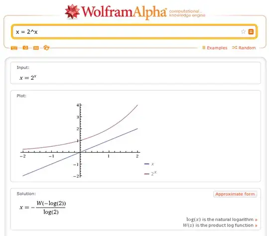

In fairness, WolframAlpha does give you the answer when you type in "x=2^x". Here's the output I see:
Now, the "Solution" might look a little strange but, if I hit the "Approximate form" I see that it's approximately $0.824679+1.56743 i$ - a complex number.
