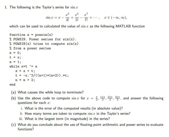

I have been stick in this question for a long time, it is a question about Taylor’s series for $\sin x$.
The question required that we should explain the terminate condition of this program.I 've try this code and I think if t smaller than the round-of error corresponding s, the program will terminate.
Also for Q2, does it means the error of actual value of sin(x) and sin(x) calculated by the code?
I am a starter of matlab and please give me some advice :)

Question $(b)$ is interesting.
Let us write $$\sin(x)=\sum_{i=0}^p \frac {(-1)^n}{(2n+1)!}x^{2n+1}+\sum_{i=p+1}^\infty \frac {(-1)^n}{(2n+1)!}x^{2n+1}$$ Since it is an alternating series, the maximum error is given by the first neglected term.
So, if you want $k$ exact significant figures, you need to find $p$ such that $$R_p=\frac {x^{2p+3}}{(2p+3)!}\leq 10^{-k}\implies (2p+3)! \geq x^{2p+3}\,10^k$$
Have a look at this question of mine; you will find a magnificent approximation provided by @robjohn, an eminent user on this site. Adapted to your problem, this would give $${2p+3\sim ex\,\exp\left(W\left(\frac{2 k \log (10)-\log (2 \pi x)}{2 e x}\right)\right)-\frac12}$$ that is to say $${p\sim \frac {e x} 2\exp\left(W\left(\frac{2 k \log (10)-\log (2 \pi x)}{2 e x}\right)\right)-\frac74}$$
Using it for $x=\frac \pi 6$ and $k=12$, this would give $p=4.48$ then $p=5$.
Let us try $$R_4=\frac{ \left(\frac{\pi}{6}\right)^{11} }{11! }=2.03 \times 10^{-11} \qquad \text{while} \qquad R_5=\frac{ \left(\frac{\pi}{6}\right)^{13} }{13! }=3.57 \times 10^{-14}$$

For (a), you are right, the loop terminates when $s \ne s+t$, where $t$ is the next term in the series you try to add on.
For (b), you can certainly easily compute $\sin(\pi/2), \sin(11\pi/2), \ldots$ by hand and the problem asks you to compare the analytic values of the function to those that are produced by the code, as well as look at some other considerations and draw conclusions about floating-point arithmetic and power-series approximations to functions.
gt6989b
  • 54,930
    For (b), Do I just need to compare the result of directly calling the sin(x) function in matlab and the sin(x) generated by powsin(x)? – Jerry Wong Apr 06 '20 at 14:10
    Also for (a), does it means t smaller than the float-point round-off error and the computer just treat them as the same? – Jerry Wong Apr 06 '20 at 14:14
    @JerryWong for (b), you can compare to MATLAB sin() call, but doing this by hand is much easier, they are all $\pm 1$. for (a), yes – gt6989b Apr 06 '20 at 16:30
