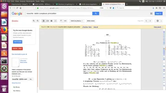

If $\omega$ is a primitive 21st root of unity, and we take $$ \alpha = \omega + \omega^4 + \omega^{16} \; , \; $$ we find that $$ \alpha^4 - \alpha^3 - \alpha^2 - 2 \alpha + 4 = 0. $$ See page 202 in Reuschle(1875). This polynomial is irreducible over the rationals, but factors as $$ \left( x^2 - \left( \frac{1 + \sqrt{21}}{2} \right) x + 2 \right) \left( x^2 - \left( \frac{1 - \sqrt{21}}{2} \right) x + 2 \right) $$

    @Piquito thanks. The entire Reuschle book is on that web page. I was able to order a paperback reprint for very little money. I recommend it for anyone answering questions on MSE. When a question can be answered with Gausses cyclotomic method, that is typically the most illuminating way to work it. – Will Jagy Apr 06 '20 at 02:47

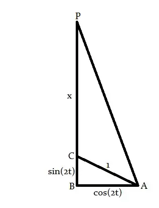

  • I allow myself to tell you what I was doing (you know how appreciated is elementary where the topic is not). In the attached figure, $\angle{CAP}= 8t$ so $\cos(10t)=\dfrac{\cos(2t)}{\overline{AP}}$. By the comment I deduced above I get $\overline{AP}^2=\dfrac{2\cos^2(2t)}{1-\cos(t)}$ so the segment $x=\overline{CP}$ is determined and also $\cos(8t)$ for the triangle $\triangle CAP$. In sum I can get a fonction $$S=f(\cos(2t),\cos(t))$$ but I don't know if $f$ was going to be complicated. Anyway I have left the problem. Thanks for your attention.I apologize. – Ataulfo Apr 06 '20 at 03:44
COMMENT.- I apologize for the attached figure to ilustrated a comment above.
