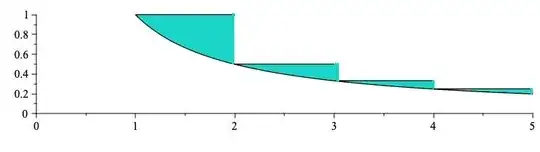

Here is a pictorial answer. Some people may like it more than a wordy answer.
Let $$ A_n = \sum_{k=1}^{n-1}\frac{1}{k} - \log n $$ Since $A_n$ differs from the term in the question by $\frac{1}{n}$ and $\frac{1}{n} \to 0$, it suffices to show that $A_n$ converges.
Here we have shaded something with area $A_5$.
A
The lower graph is $y=1/x$ between $x=1$ and $x=5$.
The horizontal line segments are:
$y=1$ from $x=1$ to $x=2$;
$y=1/2$ from $x=2$ to $x=3$;
$y=1/3$ from $x=3$ to $x=4$;
$y=1/4$ from $x=4$ to $x=5$.
The area beow the graph of $y=1/x$ is $\int_1^5\frac{dx}{x} = \log 5$. The area below the horizontal line segments is $\sum_{k=1}^4\frac{1}{k}$. The shaded area is the difference $A_5$.

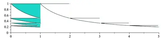

Now translate these pieces to the left until they bump the $y$-axis.
B
The pieces are disjoint, and are contained in the square $[0,1] \times [0,1]$. When we go from $A_n$ to $A_{n+1}$ we add one more of these pieces. So the sequence $A_n$ is increasing, and bounded above by $1$. Therefore $A_n$ converges.
