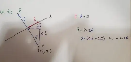

In my geometry class, we're currently learning about isometries and different types of transformations. In particular, we're asked to try to generalize what a reflection transformation does to a point $p$ over a line $\ell$ (Shown in the figure below). This got me wondering how a reflection would look like over a circle, parabola, or any function and what a generalization for such a reflection would be. How would I go about trying to generalize these reflections? Thanks! enter image description here

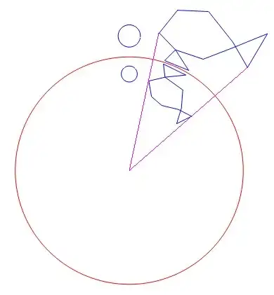

Here is an answer for the reflection with respect to circles.
There is a natural reflection transform with respect to circles provided by the "inversive transform" (or "inversion") which, in its normalized form (with a unit radius circle) can be described in such a way :
$$M(x,y) \mapsto M'(X,Y) \ \ \iff \ \ \vec{OM}.\vec{OM'}=1 \ \ \iff \ \ \ \vec{OM'}=\dfrac{1}{OM^2}\vec{OM}$$
giving formulas :
$$\begin{cases}X&=&\dfrac{x}{x^2+y^2}\\Y&=&\dfrac{y}{x^2+y^2}\end{cases}\tag{1}$$
3 basic properties of inversion :
  • The closer point $M$ is from the center, the fartest is point $M'$.
  • (involutivity) If the image of $M$ is $M'$, the image of $M'$ is $M$.
  • The points of the unit circle are invariant. (It is called the "circle of inversion").
Fig. 1 : The fish is "more or less mirrored" into the circle of inversion (fish bowl !) into another deformed fish ; note that its pectoral fin, close to the border is almost perfectly mirrored into the circle, whereas the tail fin has undergone a magnification by $\approx 2$.
For a thorough introduction, see this excellent document. See as well the first image on this excellent question (it is mine ! :)).
