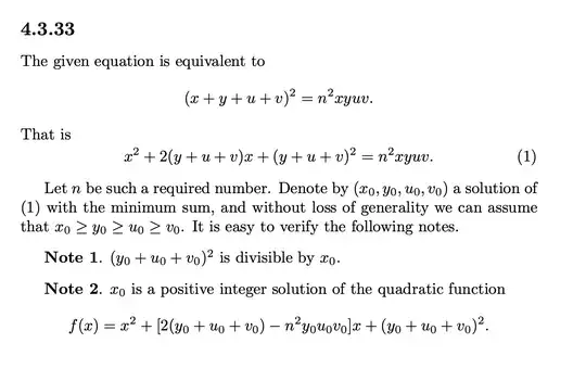

Find all positive integers $n$ for which the equation
$$ x + y + u + v = n \sqrt{ xyuv } $$
has a solution in positive integers.
This problem is taken from Vietnamese Mathematical Olympiad, 2002, Question B5
Context: Will Jaggy requested this problem and solution to be posted. See his comment

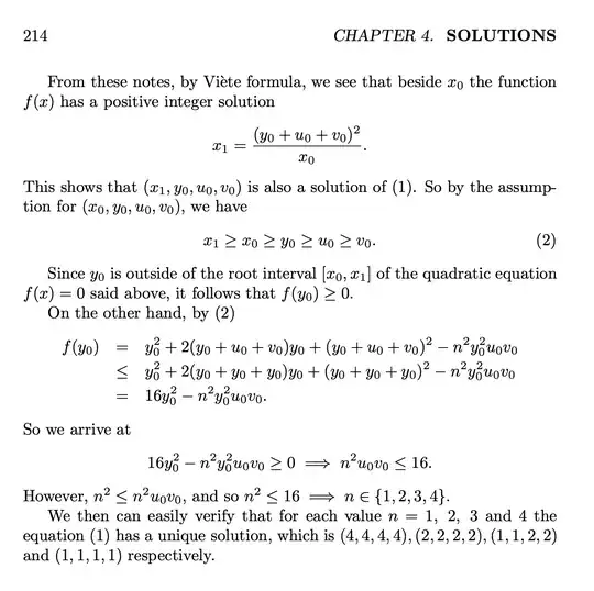

Solution from Selected Problems of the Vietnamese Mathematical Olympiad (1962–2009). (Volume 5, Mathematical Olympiad Series)

here is my list of (x+y+z+t)^2 = kxyzt in positive integers. Note k need not be a
square.
ordered and fundamental integers x >= y >= z >= t >= 1,
( x+y+z+t)^2 = kxyzt   and 2(x+y+z+t)  <= kyzt:
      k               x      y      z      t

    I suspect they used $ k = n^2$ to make it easier to find the solutions once there's a bound on $n$. – Calvin Lin Mar 28 '20 at 19:34
  • @CalvinLin I think I have found the difference. Hurwitz minimizes the sum of variables subject to being in the same tree. Your Vietnam authors are taking the smallest sum out of all trees with the same multiplier, so they get just one. Yes, at the end they print the roots of the specific trees chosen. That suffices for finding the possible coefficients. Alright, I'm getting there. Thanks for the post. – Will Jagy Mar 28 '20 at 19:43
  • and, had they allowed coefficient 3, they would lose uniqueness for the smallest sum, as sum 12 (double sum 24) has either root 4431 which is primitive, or 6222 of which all are even – Will Jagy Mar 28 '20 at 19:49
