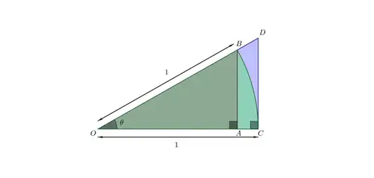

Let's prove an inequality using some geometry :
Let $ \theta \in\mathbb{R} \cdot $ Observe the following figure :
Denoting $ \mathscr{A} $ the red region, (The triangle $ OBC $), $ \mathscr{B} $ the green one, (A part from the unit disc that has a circumference of $ \theta $), $ \mathscr{C} $ the ble one, (The triangle $ OCD $). $ \mathscr{S}_{\mathscr{A}} $, $ \mathscr{S}_{\mathscr{B}} $ and $ \mathscr{S}_{\mathscr{C}} $ are their respective areas.
We have : \begin{aligned} \mathscr{S}_{\mathscr{A}}\leq\mathscr{S}_{\mathscr{B}}\leq\mathscr{S}_{\mathscr{C}}\ \ \ \ \ \\ \iff \frac{\sin{\theta}\cos{\theta}}{2}\leq\frac{\theta}{2}\leq\frac{\tan{\theta}}{2}\ \ \ \\ \iff \ \ \ \ \ \ \ \cos{\theta}\leq\frac{\sin{\theta}}{\theta}\leq\frac{1}{\cos{\theta}}\end{aligned}
Meaning, we have $ \lim\limits_{\theta\to 0}{\frac{\sin{\theta}}{\theta}}=1 \cdot $

    Thank you for the proof but I'm not quite allowed to use the squeeze theorem, which is what you utilized. We haven't proved that yet in the text I'm using. – Mousedorff Mar 26 '20 at 05:06
