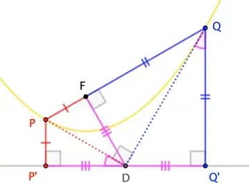

From the geometry of the standard parabola, we "know":
If the asymptotes at points $P$ and $Q$ of a parabola meet at a right angle at $D$, then
  1. $D$ lies on the directrix of the parabola.
  2. Focus $F$ of the parabola lies on $\overline{PQ}$.
Further, as a consequence of the Reflection Property of the parabola, the reflection $P'$ of $F$ in asymptote $\overline{DP}$ is perpendicular to the directrix; since reflection provides that $\overline{FP}\cong\overline{PP'}$, and the definition of the parabola requires that $P$ is equidistant from $F$ and the directrix, we have that $P'$ is actually the foot of the perpendicular from $P$ to the directrix. Since $\triangle DFP\cong\triangle DP'P$, we conclude that $F$ is the foot of the perpendicular from $D$ to $\overline{PQ}$.
Applying this to the problem at hand ... Let the points be $P:=(3,3)$ and $Q:=(1,-1)$, and define $D:=(0,0)$.
  • One readily determines the line through $D$ perpendicular to $\overline{PQ}$, and thus also the intersection $F$ of that perpendicular and $\overline{PQ}$.
  • Easily reflecting $F$ over asymptote $y=x$ gives a point on the directrix. Since the origin is also on the directrix, finding the equation is straightforward.
