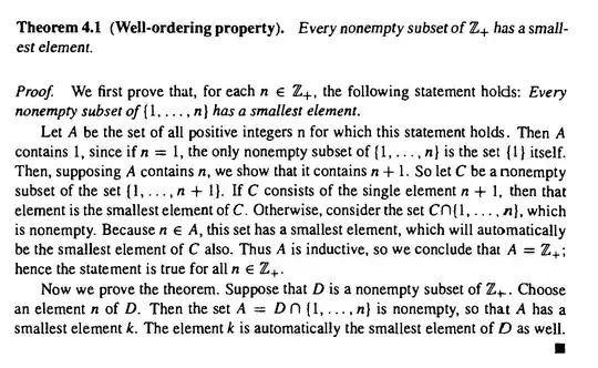

Here is another proof from the book Topology by Munkres:
    is it obvious that the smallest element of intersection of D and {1, ..., n} is the smallest element of D as well? – mathslover Feb 27 '21 at 17:36
  • @mathslover The smallest element $k$ is in ${1,…,n}$, which is equivalent to $k\leq n$. We know that $k\in D$, but suppose $k$ is not the smallest element of $D$. Then $\exists d\in D$ such that $d<k$ and thus $d\leq n$ and thus $d\in D\cap{1,…,n}=A$. But $k$ is the smallest element of $A$, so $k\leq d$, which is a contradiction. – Ryan Bell Aug 09 '24 at 01:48
