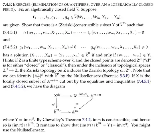

Applying Chevalley's Theorem to Elimination of quantifiers
And now I'm having some trouble showing that $(im \pi) \cap \bar{k}^m =Y = im{\pi}^{cl}$
What I have tried : It's suffice to show that there exists a closed point in $\pi^{-1}(c)$, where $c$ is any closed point of $\mathbb{A}^{m}$,so I want to use the fact if $X$ is a quasicompact scheme, then every nonempty closed subset of $X$ contains a closed point of $X$(vakil's FOAG, 5.1.E). So it remains to show $X$ is quasicompact, which could be done by noticing that intersection of an quasicompact open set and quasicompact closed set is again quasicompact.
Does this approach work? But I think it could be done directly without ivoking the fact about closed point in quasicompact scheme, which I can't figure out, could you help me? Thanks in advance.
