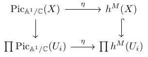

Step 0. We reduce to the case where $X$ is affine. Consider any affine open cover $X=\bigcup U_i$ and the commutative diagram
The right vertical morphism is injective because $h^M$ is a Zariski-sheaf. Thus it suffices to show that each $\eta_{U_i}\colon \operatorname{Pic}_{\mathbb A^1/\mathbb C}(U_i)\rightarrow h^M(U_i)$ has image a single point.

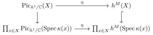

Step 1. We do the case where $X$ is reduced (and affine). For a point $x\in X$ let $\kappa(x)$ denote its residue field. We first claim that $h^M(X)\rightarrow \prod_{x\in X} h^M(\operatorname{Spec}\kappa(x))$ is injective again. After passing to an affine cover of $X$ that is mapped into an affine cover of $M$ and using some simple arguments as in Step 0, this boils down to the following question: Let $A$ be a reduced ring and $f,g\colon B\rightarrow A$ two ring morphisms that agree after composition with $A\rightarrow \kappa(\mathfrak p)$ for all $\mathfrak p\in \operatorname{Spec} A$. Then $f=g$. Indeed, the difference $f-g$ must have image contained in $\bigcap_{\mathfrak p\in \operatorname{Spec} A}\mathfrak p=0$ since $A$ is reduced.
Now consider the diagram
and observe that the bottom left product is a single point because both $\operatorname{Pic}(\operatorname{Spec} \kappa(x)[t])$ and $\operatorname{Pic}(\operatorname{Spec} \kappa(x))$ are trivial for all $x\in X$ (since line bundles over a UFD are trivial). So injectivity of the right vertical arrow does the trick.
