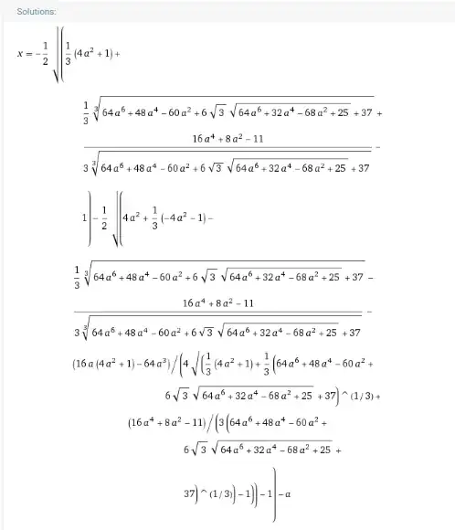

I have the equation $x^4$+4a$x^3$+(4$a^2$+1)$x^2$−1=0, whereas I'm trying to find the solutions of x in terms of a.

My problem is that I haven't been able to find any program online to do this with.
Here is an answer using WolframAlpha.
For example, here's one solution it gives:
And if you follow the link, you'll find the other 3.

  • Why should a copy pasted image file of an equation generated automatically from a computer be worthy of praise? No originality or thought put into it. If you can find it on google of by having wolfram solve it for you then an external link to the source would have sufficed. Exactly the sort of linking you criticize my answer for. You cant even be intellectually self-consistent, can you? – CogitoErgoCogitoSum Mar 15 '20 at 14:48
  • Just FYI, stackexchange has a pre-existing template for answers that use WolframAlpha. As soon as I pasted the WolframAlpha link, it suggested the format for the post above.
    Furthermore, originality/creativity is not needed to answer this question. This was a technical question with a straightforward answer. Wolfram shows the steps, so it is quite useful in this scenario.
    – Jordan Apr 07 '20 at 07:04
