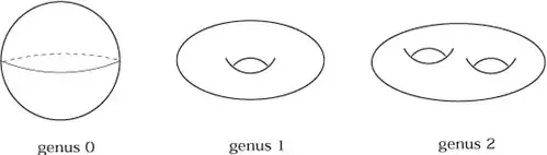

The usual topological interpretation that one sees mentioned in the books when they talk about the genus is as the number of holes in the surface $X(\mathbb{C})$. Thus I was just wondering if there's some way to see intuitively or at least without having to resort to highly technical arguments using scheme theory why this happens?
To be more specific, is there a way to see intuitively how the fact that the surface $X(\mathbb{C})$ has more than one hole (when the genus is greater than one) prevents the corresponding algebraic curve from having an infinite number of $K$-rational points?
