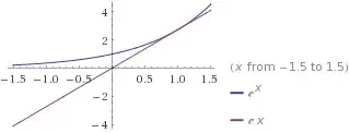

No, the graphical approach is fastest and most easy. Here are three cases for a;
a=e
a<e;a=2
a>e;a=10
You can see there are 2 solutions for every a$\not=$e; a>0;
Even without much of graphing or solving, we can see that $x=1$ is a solution for each a. Now at $x=1$ , $ax$ will increase at a higher than $a^x$ . So, the straight line moves up the a^x curve. But at large $x$ this has to get reversed . So, there would be another solution for $x>1$

  • (+1) Nice. You can conclude in the end that $a^x$ moving to infinity faster than $ax$. Thus, you see only two solutions. – Inceptio Apr 09 '13 at 16:15
  • Yes it is so, we can check it via differentiation. – ABC Apr 09 '13 at 16:16
  • Exponential functions $a>1$ tend to infinity faster than $ax$. I don't think you need to differentiate to check that. – Inceptio Apr 09 '13 at 16:18
  • Yes of course. Even for me I had even not drawn the graphs but then also concluded that there would be 2 solutions. It goes like $\uparrow$ I'll edit my answer. – ABC Apr 09 '13 at 16:21
