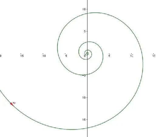

The parameterized spiral used as an example is
$$ \begin{align} \alpha(t) &= \left (e^{-0.2t} \cos(t),e^{-0.2t}\sin(t)\right) \end{align} $$
and the function $s(t)$
$$\begin{align}I \to \mathbb R\\ s(t) =\int_{t_o}^t \vert \alpha'(u)\vert du \end{align}$$
corresponds to the length of the curve from $t_o$ to $t,$ which in the example under consideration is
$$ \begin{align}s(t) &=\int_0^t \vert \left (e^{-0.2t} \cos(t),e^{-0.2t}\sin(t)\right) \vert dt\\&=\small \int_0^t \sqrt{ (-0.2)^2e^{-0.2t} \cos^2(t)+e^{-0.2t} \sin^2(t)+(-0.2)^2e^{-0.2t}\sin^2(t)+e^{-0.2t} \cos^2(t)} dt\\ &=\frac{e^{-0.2t}-1}{-0.2}\sqrt{(-0.2)^2+1} \end{align}$$
Its inverse is
$$\varphi(g)=s^{-1}(g)=-5 \log(-0.196116 (g - 5.09902))$$
And the tangent to the curve parameterized by the arc length, i.e. $\beta(g)=\alpha\circ\varphi=\alpha(\varphi(g))$:
$$\begin{align} &\\\beta'(g)&=\alpha'\left( \varphi(g)\right)\varphi'(g)\\ &=\small{ (0.98058\sin(5\ln(-0.196116 (x - 5.09902))) - 0.196116\cos(5\ln(-0.196116 (g - 5.09902))),} \\ &\small{0.196116\sin(5\ln(-0.196116 (g - 5.09902))) + 0.98058\cos(5\ln(-0.196116 (g - 5.09902))))} \end{align}$$
yielding unitary tangent vectors to each point on the curve:
