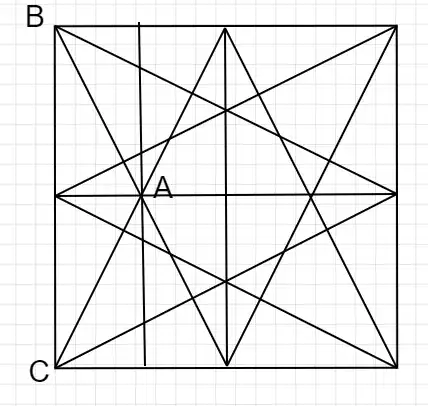

So far, the easiest way I could think of was to use the cosine rule to get the largest angle in $\triangle ABC$ (below) and show that the total of the angles would not be equal to the expected sum of a regular octagon.

  • Some basic trigonometry on a $1,2,\sqrt{5}$ triangle will tell you all the angles you need and will prove that the angles are not all $135^\circ$. Incidentally, the side length of the square is irrelevant. The important fact is that it is a square. – nickgard Feb 18 '20 at 08:53

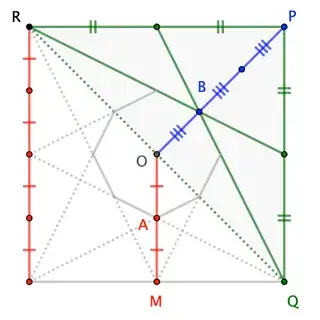

$$\underbrace{|OA| = \frac12|OM|}_{\text{$A$ is the midpoint of $\overline{OM}$}}=\;\; \frac14|PQ| \;\;\color{red}{\neq}\;\; \frac13\cdot\frac1{\sqrt{2}}|PQ| \;\;= \underbrace{\frac13|OP| = |OB|}_{\text{$B$ is the centroid of $\triangle PQR$}}$$

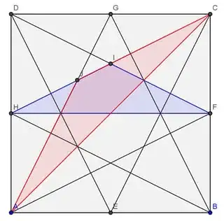

Here is a better way that requires absolutely no calculation at all.
octagon in square with two isosceles triangles each of which comprises a diameter and two sides of the octagon
If the octagon is regular, then rotating the blue triangle would yield the red triangle, but clearly the blue triangle has the shorter long side.

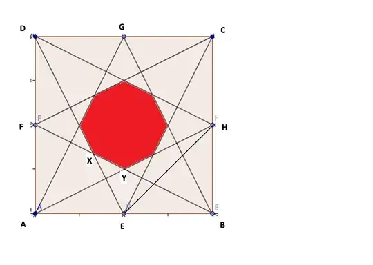

A regular octagon has all its exterior angles equal, so to demonstrate non-regularity it suffices to show that there are two exterior angles which are not equal to each other. In the diagram below we focus on showing that $\angle EXB <\angle AYF$. enter image description here Given that $ABCD$ is a square and $E,F,G,H$ are midpoints, we can infer that $EB=BH=\frac{1}{2}AD$ and hence, using Pythagoras' Theorem, $EH=\frac{\sqrt{2}}{2}AD$ so that $EH < AD$.
Focusing now on $\triangle EDH$ and $\triangle AHD$, we have $ED=DH=AH$, so both are isosceles and their equal sides are the same. Hence, since $EH < AD$, $\angle EDH < \angle AHD$.
Since $F$ and $H$ are mid-points of sides $AD$ and $BC$ respectively of the square, $BF$ and $HD$ are parallel, and so $\angle EXB = \angle EDH$ and $\angle AYF = \angle AHD$. Hence:
$$\angle EXB = \angle EDH < \angle AHD = \angle AYF$$
QED
