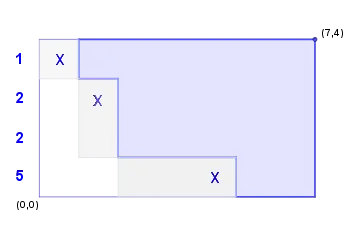

This is a starter providing some ideas which can be used to iteratively determine the number of ways to eat an $(m\times n)$ chocolate bar. We consider an $(m\times n)$ rectangle and start eating from bottom left to top right. The graphic below shows a valid configuration of a $(7\times 4)$ chocolate bar after three bite indicated by $X$.
Valid paths:
We characterize a valid path by an $n$-tupel giving for each $y$, $1\leq y\leq n$ the corresponding $x$-value , $1\leq x\leq m$. The valid path in the graphic is encoded this way as ${(1,2,2,5)}$. We have a total of $\binom{m+n}{n}$ valid paths and consider these paths as building blocks to determine the number of ways to eat the chocolate bar. A valid path is encoded as $(x_1,x_2,\ldots,x_n)$ with $0\leq x_1\leq \cdots \leq x_n\leq m$. The final path is $(m,m,\ldots,m)$.
In order to determine the number of ways to obtain $(1,2,2,5)$ we consider all possible predecessors from which we can get $(1,2,2,5)$ in one step. We add up the number of ways to obtain all predecessors and get so the number of ways for $(1,2,2,5)$. The predecessors of $(1,2,2,5)$ are indicated by the grey shaded regions and are \begin{align*} (\color{blue}{0},2,2,5)\qquad (1,2,2,\color{blue}{2})\\ (1,\color{blue}{1},2,5)\qquad (1,2,2,\color{blue}{3})\\ (1,\color{blue}{1},\color{blue}{1},5)\qquad (1,2,2,\color{blue}{4})\\ \end{align*} The blue marked coordinates are to bite off to come to $(1,2,2,5)$.
Example: $m=n=3$
We determine this way the number $p_{(3,3,3)}$ of possible ways to eat a $(3\times 3)$ chocolate bar which is according to OP's table \begin{align*} \color{blue}{p_{(3,3,3)}=1\,232} \end{align*} We start determining the $\binom{6}{3}=20$ valid paths. These are:
\begin{align*} &(0,0,0)\\ &(0,0,1)\,(0,1,1)\quad\quad\quad\quad\quad\quad\,\,\,\, (1,1,1)\\ &(0,0,2)\,(0,1,2)\,(0,2,2)\qquad\quad\,\,\,(1,1,2)\,(1,2,2)\qquad\quad\,\,\,(2,2,2)\\ &(0,0,3)\,(0,1,3)\,(0,2,3)\,(0,3,3)\,(1,1,3)\,(1,2,3)\,(1,3,3)\,(2,2,3)\,(2,3,3)\,(3,3,3) \end{align*}
We calculate iteratively $p_{(3,3,3)}$ by starting with $p_{(0,0,0)}=1$. We obtain \begin{align*} p_{(0,0,0)}&=1\\ \color{blue}{p_{(0,0,1)}}&=p_{(0,0,0)}\color{blue}{=1}\\ \color{blue}{p_{(0,0,2)}}&=p_{(0,0,1)}+p_{(0,0,0)}=1+1\color{blue}{=2}\\ \color{blue}{p_{(0,0,3)}}&=p_{(0,0,2)}+p_{(0,0,1)}+p_{(0,0,0)}=2+1+1\color{blue}{=4}\\ \\ \color{blue}{p_{(0,1,1)}}&=p_{(0,0,1)}+p_{(0,0,0)}=1+1\color{blue}{=2}\\ p_{(0,1,2)}&=p_{(0,1,1)}+p_{(0,0,1)}+p_{(0,0,0)}=2+1+1=4\\ p_{(0,1,3)}&=p_{(0,1,2)}+p_{(0,1,1)}+p_{(0,0,3)}=4+2+4=10\\ \color{blue}{p_{(0,2,2)}}&=p_{(0,1,2)}+p_{(0,1,1)}+p_{(0,0,2)}\\ &\quad+p_{(0,0,1)}+p_{(0,0,0)}=4+2+2+1+1\color{blue}{=10}\\ p_{(0,2,3)}&=p_{(0,2,2)}+p_{(0,1,3)}+p_{(0,0,3)}=10+10+4=24\\ \color{blue}{p_{(0,3,3)}}&=p_{(0,2,3)}+p_{(0,2,2)}+p_{(0,1,3)}+p_{(0,1,2)}\\ &\quad+p_{(0,1,1)}+p_{(0,0,3)}+p_{(0,0,2)}+p_{(0,0,1)}+p_{(0,0,0)}\\ &=24+10+10+4+2+4+2+1+1\color{blue}{=58}\\ \\ \color{blue}{p_{(1,1,1)}}&=p_{(0,1,1)}+p_{(0,0,1)}+p_{(0,0,0)}=2+1+1\color{blue}{=4}\\ p_{(1,1,2)}&=p_{(1,1,1)}+p_{(0,1,2)}+p_{(0,0,2)}=4+4+2=10\\ p_{(1,2,2)}&=p_{(1,1,2)}+p_{(1,1,1)}+p_{(0,2,2)}=10+4+10=24\\ p_{(1,1,3)}&=p_{(1,1,2)}+p_{(1,1,1)}+p_{(0,1,3)}+p_{(0,0,3)}=10+4+10+4=28\\ p_{(1,2,3)}&=p_{(1,2,2)}+p_{(1,1,3)}+p_{(0,2,3)}=24+28+24=76\\ p_{(1,3,3)}&=p_{(1,2,3)}+p_{(1,2,2)}+p_{(1,1,3)}+p_{(1,1,2)}+p_{(1,1,1)}\\ &=76+24+28+10+4+58=200\\ \\ \color{blue}{p_{(2,2,2)}}&=p_{(1,2,2)}+p_{(1,1,2)}+p_{(0,2,2)}+p_{(0,1,2)}+p_{(0,0,2)}\\ &\quad+p_{(1,1,1)}+p_{(0,1,1)}+p_{(0,0,1)}+p_{(0,0,0)}\\ &=24+10+10+4+2+4+2+1+1\color{blue}{=58}\\ p_{(2,2,3)}&=p_{(2,2,2)}+p_{(1,2,3)}+p_{(1,1,3)}\\ &\quad+p_{(0,2,3)}+p_{(0,1,3)}+p_{(0,0,3)}\\ &=58+76+28+24+10+4=200\\ p_{(2,3,3)}&=p_{(2,2,3)}+p_{(2,2,2)}+p_{(1,3,3)}+p_{(0,3,3)}\\ &=200+58+200+58=516\\ \\ \color{blue}{p_{(3,3,3)}}&=p_{(2,3,3)}+p_{(2,2,3)}+p_{(2,2,2)}+p_{(1,3,3)}+p_{(1,2,3)}\\ &\quad+p_{(1,2,2)}+p_{(1,1,3)}+p_{(1,1,2)}+p_{(1,1,1)}+p_{(0,3,3)}+p_{0,2,3)}\\ &\quad+p_{(0,2,2)}+p_{(0,1,3)}+p_{(0,1,2)}+p_{(0,1,1)}+p_{(0,0,3)}+p_{(0,0,2)}\\ &\quad+p_{(0,0,1)}+p_{(0,0,0)}\\ &=516+200+58+200+76+28+24+10+4+58\\ &\quad+24+10+10+4+2+4+2+1+1\\ &\,\,\color{blue}{=1\,232} \end{align*} and we obtain $p_{(3,3,3)}=1\,232$ according to OP's table. Entries with a rectangular shape are marked in blue. They are also given in OP's list.

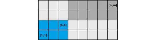

Let the chocolate bar rectangle span from $(1,1)$ to $(n,m)$. For $b\ge2$, we have $(b-1)$ nontrivial bites. Imagine $i$th nontrivial bite $B_i$ as a rectangle with one corner at $(1,1)$ and the opposite corner at $(a_i,b_i)$. We need to sum over all of the possible ways to place these rectangles, such that when placing the corner $(a_i,b_i)$ of the next rectangle (bite) $B_i$, we do not place it into an already eaten square (square already contained within one of the previous bites).
When $b=2$, we have one nontrivial bite, which can be at any square except $(n,m)$.
$$F_2=-1+\sum_{a_1,b_1\gt0,0}^{n,m}1=nm-1$$

Let $b\ge1$ and let $(b+1)$th bite be the last bite. Let $f_{b-1}(t)$ be the total number of eaten squares after $(b-1)$th bite, of some biting sequence indexed $t$. Then the next-to-last bite, the $b$th bite, can be any of the uneaten squares (except the top-right corner square which is the last bite). That is, any of the $nm-1-f_{b-1}(t)$ squares. This gives a recursion in variable $b$:
$$\begin{align} F_{b+1}&=\sum_{t=1}^{F_b}\left(nm-1-f_{b-1}(t)\right)\\ F_{b+1}&=(nm-1)\cdot F_b-\sum_{t=1}^{F_b}f_{b-1}(t) \end{align}$$
Specially, $f_0(t)=0$ since the zeroth bite (no bites have been made yet) removes no squares.
The base case is $F_1=1$, since the only possible bite is the last bite.
We again give examples for first two cases, below:
For $b=1$, the recursion gives $F_2(n,m)=(nm-1)$, which makes sense, since first bite can be any of the $nm$ squares except the top-right corner, which is the last bite.
For $b=2$, we are observing the sum of $f_1(t)$ which goes over all possible removals of squares, given one bite. This is equivalent to observing all possible rectangles $a\times b$ within the original chocolate bar $n\times m$ rectangle, except the $n\times m$ rectangle itself. We can sum the areas of all of the rectangles:
$$ \sum_{a,b}R(a,b)=(1+2+\dots+n)(1+2+\dots+m)=\frac{n(n+1)}{2}\frac{m(m+1)}{2} $$
Then subtract the area of the $n\times m$ rectangle itself, $R(n,m)=nm$.
$$\begin{align} F_{3}&=(nm-1)\cdot(nm-1)-\sum_{t=1}^{nm-1}f_{1}(t) \\ F_{3}&=(nm-1)^2-\left( \frac{n(n+1)}{2}\frac{m(m+1)}{2}-nm\right)\\ F_{3}&=\frac14(3 m^2 n^2 - m^2 n - m n^2 - 5 m n + 4) \end{align}$$
