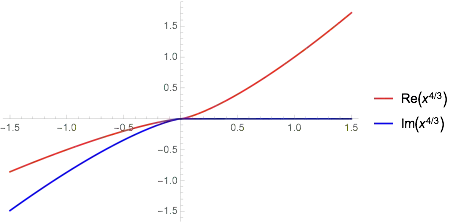

The function is defined for positive and negative values of $x$. The graph shows the real and imaginary parts:
Mathematica plot
$${\rm Re}[(-1)^{4/3}] = -\frac{1}{2}$$
$${\rm Im}[(-1)^{4/3}] = - \frac{\sqrt{3}}{2}$$
Given that there is no unique way to compute a partial root of a negative number, Mathematica seems to assume the most general complex form.
There is no reason that the function should be (or is) symmetric with respect to the interchange $x \leftrightarrow -x$.
