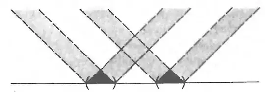

In the last paragraph, I do not know how to visualize the closure $\operatorname{cl}B(x,\epsilon)$ in this "weird" topology. I guess it may be the union of four half infinite "rational" strips but I am not sure. Could anyone give a picture or description of the picture showing $\operatorname{cl}B(x,\epsilon)$?
As you correctly guessed the closure of every basic open set $B(x,\varepsilon)$ contains four stripes, since every point inside one of those stripes projects to a point within $\varepsilon$ of either $l(x)$ or $r(x)$ along a line of slope $1/\sqrt{3}$. In other words if $y$ is in one of the stripes every neighbourhood of $y$ intersects $B(x,\varepsilon)$, so $y\in\mathrm{cl}B(x,\varepsilon)$.
The Bing space is space n.75 in "Counterexamples in Topology" by Steen ad Seebach, where you can find the following illustration of the closure of a basic open set, together with many more properties of this space (there's also other connected countable Hausdorff spaces in the book, such as 61 and 125).
It should now be clear why every pair of basic open sets have intersecting closure and hence why the space is connected.
