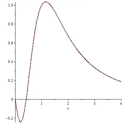

Let $f(x) = 1 - \frac{(1+x)^2}{(1+x^2)^2}$. We need to prove that $f(u)+f(v)+f(w)\ge 0$. The method of Lagrange multipliers yields the system of equations \begin{align} f'(u) &= \lambda vw, \\ f'(v) &= \lambda uw, \\ f'(w) &= \lambda uv, \\ uvw &= 1. \end{align} Clearly, we have $uf'(u) = vf'(v) = wf'(w) = \lambda$. Let us prove that if $(u, v, w, \lambda)$ with $u, v, w > 0$ satisfies the above system of equations, then two of $u, v, w$ are equal.
Let $F(x) = xf'(x) = \frac{2x(1+x)(x^2+2x-1)}{(x^2+1)^3}$.
Clearly, $F(0) = 0$, $F(\sqrt{2}-1) = 0$, $F(x) < 0$ on $(0, \sqrt{2}-1)$, and $F(x) > 0$ on $(\sqrt{2}-1, +\infty)$.
We have $F'(x) = -\frac{2(2x^5+9x^4-14x^2-2x+1)}{(x^2+1)^4}$. Let $G(x) = 2x^5+9x^4-14x^2-2x+1$. From Descartes' sign rule, since there are two sign changes, $G(x) = 0$ has at most two positive real roots. Also, we have $G(0) > 0$, $G(\sqrt{2}-1) = 32-24\sqrt{2} < 0$ and $G(+\infty) = +\infty$. Thus, $G(x) = 0$ has exactly one real solution on $(0, \sqrt{2}-1)$ and $(\sqrt{2}-1, +\infty)$, respectively. Thus, $F'(x) = 0$ has exactly one real solution on $(0, \sqrt{2}-1)$ and $(\sqrt{2}-1, +\infty)$, respectively.
Figure of $F(x)$: Figure of F
Thus, $F(x) = c$ has at most two distinct positive real solutions for any real number $c$. Since $F(u) = F(v) = F(w)$, we know that two of $u, v, w$ are equal.
