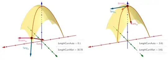

I have been working on a representation of the Frenet-Serret vectors at a point of a curve on a surface embedded in $\mathbb R^3,$ utilizing built-in equations in Geogebra, and trying to reproduce the results with "manual" expressions following the cross product formulas in here.
The problem is that, although the normal vector $\text{Curv}_m$ is in the right direction, its norm seems to move in opposite direction using the built-in formula as compared to the manually typed cross product $\left(T(t)\times T'(t)\right)\times T(t).$ This is very apparent upon visual inspection: for instance, comparing the values at the point of least curvature to the point with maximum curvature, where the values converge:
Before normalizing these vectors (as they appear on the graphs), the length of the normal vector at a point along the relatively straight segment is close to $0$ using the built-in formulas, whereas it is $30$ using the cross-product formula. At the top, markedly curved part, the values are similar at around $4$ with both methods.
Why is the cross product moving in inverse norm value as the actual curvature? And is there any adjustment that would correct this?

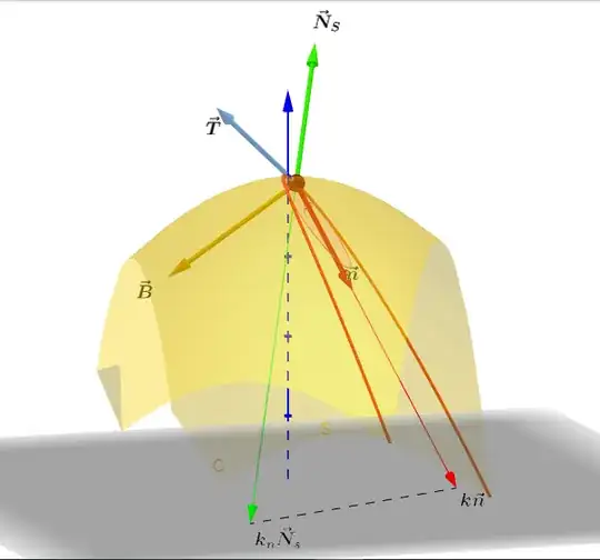

The normal curvature of the curve $C$ at the point $A$ can be found as
$$\vec n(s)=\frac{T'(s)}{\vert T'(s)\vert}=\frac 1k T'(s)$$
provided the curve is arc-length parameterized, and since $\vert T'(s)\vert$ is the curvature of the curve at $s.$
However this seems to have practical challenges in differentiating functions with cumbersome square roots in the normalizing denominators.
The "trick" in the code used to generate $\left(T(t)\wedge T'(t)\right)\wedge T(t)$ the vector is simply meant to obtain a vector in the direction of $\vec n.$ However, it will have to be normalized to unit, in which case it will only represent the curvature if its multiplied by $k,$ resulting in $k\vec n.$ In turn, $k$ can be calculated as
$$k(t)=\frac{C'(t)\wedge C''(t)}{\vert C'(t)\vert^3}$$
The projection of $k\vec n$ on the line spanned by the normal vector to the surface at $A$ results in $k_n=k\cos\theta:$
