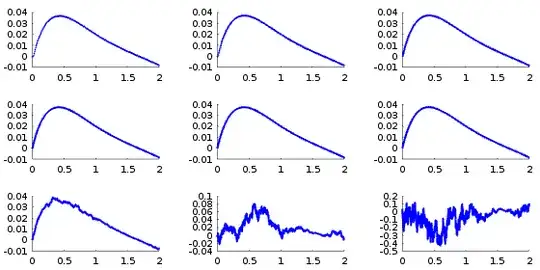

This change of the origin of the error can also nicely be seen in plots of the error profiles, where the difference to the exact solution is divided by $h^3$ to get a common scale.
The first 6 plots are almost identical, showing the dominance of the leading error term, while the last 3 show the increasing influence of the pseudo-random floating-point error accumulation.
