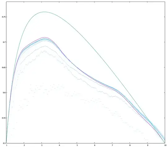

Here's a plot of the proportion of the primes that are less than their reverse for the decades up to $10^{11}$. The blue dots are the actual data for the primes, the purple curve shows the above asymptotic result for the primes, and the green curve shows the above asymptotic result for all numbers for comparison, with the maximum in the same place. The convergence to the asymptotic curve for the primes is clearly discernible. The proportion up to $10^{11}$ is about $0.5052$, consistent with your data and in rough agreement with the linear approximation above.
proportion of primes less than their reverse
