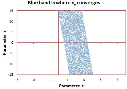

As a starting point, see the chart below for
$$2(n+2)x_{n+2}=(r (n+2) + s)x_{n+1} + ((2-r)(n+2)-s)x_n$$
with $x_0=0, x_1=1$. This 2-dimensional plot represents one slice of all the possible 3-dimensional parameter representations leading to divergence. The X-axis represents $r$, the Y-axis represents $s$. I tried with 400,000 values of $(r, s)$ to check which ones result in actual convergence. The blue dots represent the points $(r,s)$ such that $|x_{40} - x_{39}|<0.000001$. The blue area is full of holes because I only used 400,000 values of $(r, s)$ in this experiment. If you use 10,000,000 values, the boundaries will be smoother, and the holes in the blue area will vanish.
These recurrences can be represented by generalized hypergeometric functions, and according to Wikipedia, the convergence status is typically studied separately for each recurrence. Yet my chart suggests that there is a general law governing the convergence (or lack of) for these recurrences. It is an interesting math problem, and also of interest to statisticians who are interested in estimating the boundaries (in the parameter space) of the convergence region, and test whether the boundaries are parallel lines.

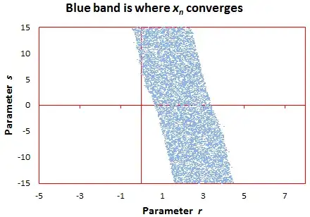

Case $q=1$:

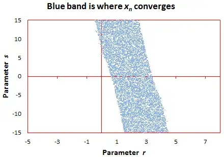

Case $q=5$:

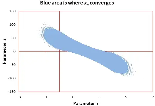

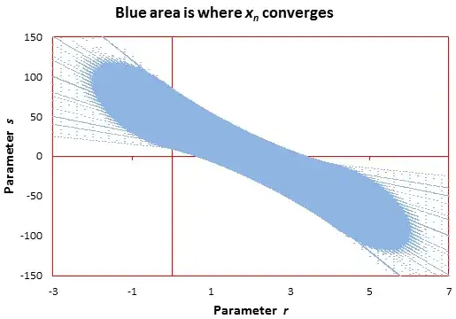

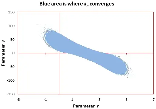

The representation $2(n+q)x_{n+2}=(r (n+q) + s)x_{n+1} + ((2-r)(n+q)-s)x_n$ is indeed standard, covering all cases where convergence could occur (other than convergence to $0$). The convergence domain for the parameters $q, r, s$ does not depend on $x_0, x_1$ unless $x_0 = x_1$: in that case $x_n=x_0$ for all $n$, regardless of $q, r, s$. I will split my response in two parts: empirical results first, and results based on theory at the bottom.
Empirical results

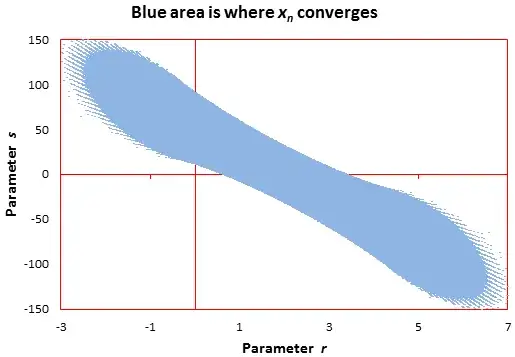

Below is the convergence domain, in blue, when $q=3.12345$. I will add more cases (other values of $q$) with their corresponding plot. It looks like the shape of the blue area is pretty stable (thought shifted and shrunk or inflated) if $q$ is different. It is not a band as initially thought, but rather a bounded area, and the boundary is a curve. This is not apparent in my original question because I looked at values of $s$ only between $-15$ and $+15$. Here I looked at $s$ between $-150$ and $+150$.
The filaments (and they extend in the central area though it is not visible in the chart below) correspond to annoying cases of convergence, that I would like to exclude. For instance, when all $x_n$ are identical after a fixed number of iterations.
Below is the plot corresponding to $q=3.12345$:

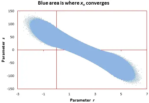

Below is the plot corresponding to $q=5.0918543$ :
Below is the plot corresponding to $q=-0.4539$:
