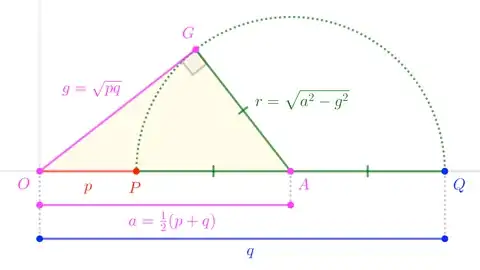

Here's a geometric justification of the approach.
Suppose $P:=(p,0)$ and $Q:=(q,0)$ are points on the positive $x$-axis. (See Note for when $p$ and $q$ differ in sign.) Consider a (semi-)circle with diameter $\overline{PQ}$.
If $A$ is the center of that circle, then $$a := |OA| = \frac12\left(|OP|+|OQ|\right) = \frac12(p+q) \tag1$$ If $G$ is the point where the tangent from $O$ meets the circle, then (by the Power of a Point theorems), $$|OG|^2 = |OP||OQ| \quad\to\quad g := |OG| = \sqrt{pq} \tag2$$ (Thus, $a$ is the arithmetic mean of $p$ and $q$, while $g$ is the geometric mean, which may explain my choice of variable names.) If $r$ is the radius of the circle, then we clearly have that $P$ and $Q$ are at distance $r$ from $A$, so that (abusing notation slightly) $$\{p,q\} \;=\; a \pm r \tag3$$ But $\triangle OAG$ has a right angle at $G$, so that Pythagoras tells us $a^2 = g^2 + r^2$. Solving for $r$, we can write
$$\{p,q\} \;=\; a \pm \sqrt{a^2-g^2} \tag{$\star$}$$
That is, $(\star)$ tells us how to calculate two numbers ($p$ and $q$) from their means ($a$ and $g$). Nifty.
Now, the relevance to the Quadratic Formula comes from supposing that the monic quadratic polynomial $x^2+Bx+C$ has those numbers $p$ and $q$ as roots. We "know" that this means the polynomial must factor as $$x^2 + Bx + C = (x-p)(x-q) = x^2-(p+q)x + pq \tag4$$ Comparing coefficients, we have $$B = -(p+q) \qquad\qquad C = pq \tag5$$ This shows that $B$ is the negative of the sum of the roots, and $C$ is the product. (Vieta's formulas generalize this observation to general polynomials.) In the context of our geometric argument, $B$ is the negative of twice the arithmetic mean, and $C$ is the square of the geometric mean. $$B = -2a \qquad\qquad C = g^2 \tag6$$ Substituting $a=-B/2$ and $g^2=C$ into $(\star)$ gives Loh's preferred form of the (monic) Quadratic Formula:
$$\{p,q\}\;=\;-\frac{B}2\pm\sqrt{\left(\frac{B}2\right)^2-C} \tag{$\star\star$}$$
I may myself prefer to think of this as "$(\star)$ + Vieta".

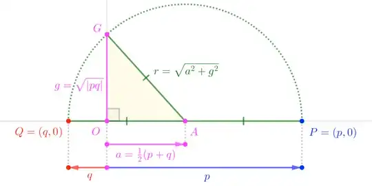

Note: Adjusting the argument for $P$ and $Q$ on opposite sides of $O$ (corresponding to quadratic roots differing in sign) gets a little fiddly depending upon how we introduce negatives into the geometry. Here, we'll consider $p$, $q$, and $a$ to be signed distances; this allows us to maintain the relation $a=\tfrac12(p+q)$. The figure for this case takes $G$ to be the point where the perpendicular at $O$ meets the circle; its (unsigned) length is the geometric mean of unsigned lengths $|OP|$ and $|OQ|$, so we write $g = \sqrt{|pq|}$.
Again, $\triangle OAG$ is a right triangle, but $r$ is now the hypotenuse, giving the counterpart of $(\star)$ this form:
$$\{p,q\} \;=\; a \pm\sqrt{a^2+g^2} \tag{$\star'$}$$
Taking $p$ and $q$ to be roots of $x^2+Bx+C$ as before, we still have relations $(5)$, because the signs of the roots don't affect the algebra leading to those relations. However, the signs do require us to write $g^2= -C$ (because $g^2=|pq|^2$ is positive, while $C=pq$ is negative). But this weirdness exactly cancels the Pythagorean sign change in $(\star')$, so that substitution gives us $(\star\star)$ again. Convenient, that.

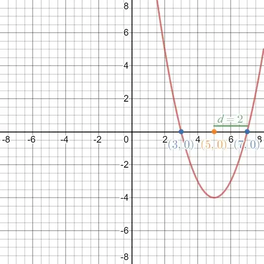

Now consider the graph of $y=x^2 – 10x + 21$ shown below. To use Loh's method, we'll need two other variables: $m$ and $d$. Where $(m, 0)$ is the midpoint of the zeros, $m$ is the average of the solutions. Then $d$ is the distance each zero is from the midpoint. Therefore, we can represent the solutions as $m-d$ and $m+d$ or as just $m \pm d$. If we could calculate $m$ and $d$ simply from $B$ and $C$, we'd have an easy way to solve a quadratic. And we can! Graph of y=x^2 – 10x + 21
Let's get to Loh's method. We'll begin by assuming we have a quadratic of the form $Ax^2+Bx+C=0$ where $A=1$. We've already established that $-B$ is the sum of our solutions. Since the mean of the solutions is their sum divided by 2, $m=\frac{-B}{2}$. Also recall that $C$ is the product of the solutions. Therefore, $C=(m-d)(m+d)=m^2-d^2$. If we rearrange this as $d^2=m^2-C$, we have an easy way to find $d$ from $m$ and $C$. We can then write our solutions as $m \pm d$.
Here's how it works out with $y=x^2 – 10x + 21$.
$m=\frac{-B}{2}=\frac{10}{2}=5$
$d^2=m^2-C=(5)^2-21=4$
Therefore, $d=\pm \sqrt 4=\pm 2$
Since $m\pm d=5\pm 2$, the solutions are 3 and 7.
That's Loh's method! Again, it's far more accessible to students just learning how to solve quadratics.
