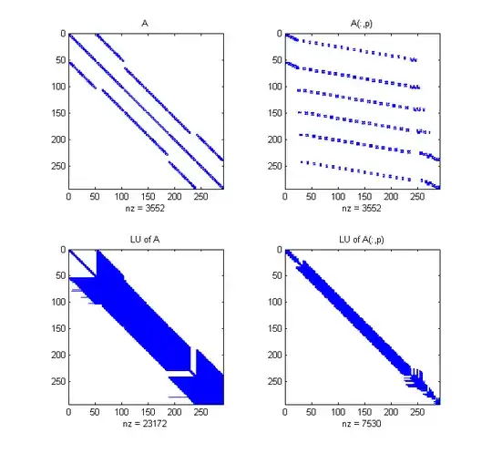

I'm dealing with some variable size square sparse matrices resulting from a FEM analysis, and my next step is optimizing the system solving in terms of speed. This is a visualization of some aspects of a typical matrix using MATLAB's spy:
MATLAB visualization
Please note I'm not using MATLAB (or this question would be useless), I just used it for generating the above graph.
The top left graph show my matrix as-is (non zero elements are blue), and bottom left shows the LU decomposition of said matrix. On the top right I have applied the COLAMD algorithm (through MATLAB function colamd) to generate a permutation to my matrix that would result in sparser LU factorized matrix, which indeed happens as the bottom right graph suggests (less than a third of the non zero elements I had before).
