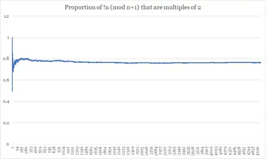

When looking at the table of $!n\pmod{n+1}$ (where by $\text{mod}$ we mean the least non-negative residue), there's no apparent pattern. However, if you look close enough, you'll notice that a disproportionate amount of elements are multiples of $2$. After calculating the first $5000$ values, this number seems to converge to around $76\%$, greater than the $50\%$ you'd expect if this sequence was random.
Proportion of !n (mod n+1) that are multiples of 2

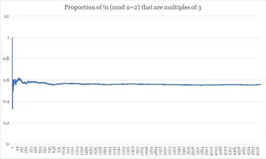

Likewise, a disproportionate amount of elements in the table of $!n\pmod{n+2}$ are multiples of $3$: $56\%$, contrasted to the expected $33\%$.
Proportion of !n (mod n+2) that are multiples of 3

First, we can observe that all odd inputs of $n$ are giving even outputs while all even inputs of $n$ are giving odd outputs. This can be justified using induction. It clearly works for the first few cases from the above table. Now, by induction hypothesis, $!n+!(n-1) \equiv 1 \pmod{2}$ which shows that $!(n+1) \equiv n \pmod{2}$ which shows that odd inputs give even outputs while even inputs give odd outputs.
For all odd values of $n$, we can see that $!n$ and $n+1$ are even which shows that the residue $!n \pmod{n+1}$ is also even. Thus, we have already acquired $50\%$ of the multiples of $2$. On the other hand, for even values of $n$, it seems like there is a $50\%$ chance of the least residue being odd or even, as expected. This gives us an expected ratio of $50\%+\frac{1}{2}(50\%)=75\%$ of even least residues which agrees with your data.
For modulo $3$, you can observe that $!n \pmod{3}$ is $0,1,2,0,2,1 \pmod{3}$ based on $n \pmod{6}$. As our formula is based on recursion, it is easy to see that similar to the above case, we can evaluate $!n \pmod{3}$ using $n \pmod{6}$. Again, like the above case, whenever $n \equiv 1,4 \pmod{6}$ i.e. whenever $n \equiv 1 \pmod{3}$, we have $!n \equiv 0 \pmod{3}$. Thus, the least residue of $!n \pmod{n+2}$ will be divisible by $3$. This is $1$ out of every $3$ cases. That gives an expected ratio of $\frac{1}{3}(100\%)+\frac{2}{3}(33.33\%)=55.55\%$, agreeing with your data.
