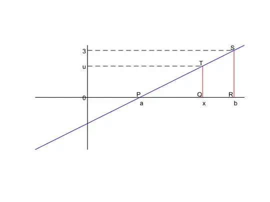

EDIT: In comments I seem to have been asked to derive the two-point formula for a line connecting $2$ points in the plane. Consider the following drawing: geometry
The line connecting the two points $P=(a,0)$ and $S=(b,3)$ has been plotted in the $uv$-coordinate plane. Also a general point $T=(x,u)$ has been plotted along the line. Line segments parallel the the $u$-axis have been drawn from $T$ and $S$ down to the $x$-axis ending at $Q=(x,0)$ and $R=(b,0)$ respectively. From geometry the triangles $\triangle PRS$ and $\triangle PQT$ are similar, so the ratios between corresponding sides are equal: $$\frac{|PQ|}{|QT|}=\frac{x-a}{u-0}=\frac{|PR|}{|RS|}=\frac{b-a}{3-0}$$ So the two-point formula for a line is $x=a+(b-a)u/3$. You can check that when $x=a$, $u=0$ and when $x=b$, $u=3$ as required.
Now, if we want to generalize this to any interval $[a,b]$ use the two-point formula to get $$\frac{x-a}{u-0}=\frac{b-a}{3-0}$$ So $x=a+\left(\frac{b-a}3\right)u=a+hu$, $dx=h\,du$ and $$\int_a^bf(x)dx=h\int_0^3f(a+hu)du=h\left(\frac38\right)\left(f(a)+3f(a+h)+3f(a+2h)+f(a+3h)\right)$$
