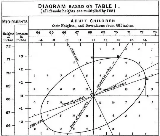

Francis Galton was the first user of "regression" in this sense. If you consider his original height data as shown in his 1875 chart below (taken from Wikipedia), it may be clearer
Taking tall parents as the top two quarters of the chart, you see how the average heights of their children are pulled to the left of the major axis, i.e. on average the children of tall parents are shorter than their parents but taller than average children (Galton illustrated this with what he called the locus of horizontal tangential points)
But taking tall children as the two right-hand quarters of the chart, you see how the average heights of their parents are pulled to the below of the major axis, i.e. on average the parents of tall children are shorter than their children but taller than average parents (Galton illustrated this with what he called the locus of vertical tangential points)
