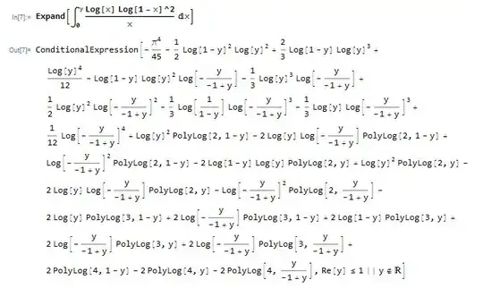

By the way, mathematica givesenter image description here

Thanks to @user97357329 for providing the key identity to solve the integral $C$,
$$\ln^3\left(\frac{x}{1-x}\right) =\ln^3(x)-3 \ln^2(x)\ln(1-x)+3 \ln(x)\ln^2(1-x)-\ln^3(1-x)$$
To have a less messy solution, I am going to evaluate the integral $C$ as an indefinite integral and the integral constant will be ignored as we will plug in the boundaries $0$ and $y$ eventually.
It follows from the identity above that
$$3\int\frac{\ln x\ln^2(1-x)}{x}dx$$
$$=\underbrace{\int\frac1{x}\ln^3\left(\frac{x}{1-x}\right)dx}_{\Large\mathcal{I}_1}+3\underbrace{\int\frac{\ln^2x\ln(1-x)}{x}dx}_{\Large\mathcal{I}_2}+\underbrace{\int\frac{\ln^3(1-x)}{x}dx}_{\Large\mathcal{I}_3}-\frac14\ln^4x$$
For $\mathcal{I}_1$, sub $\frac{x}{1-x}=t$
$$\mathcal{I}_1=\int\frac{\ln^3t}{t(1+t)}dt=\int\frac{\ln^3t}{t}dt-\int\frac{\ln^3t}{1+t}dt$$
$$=\frac14\ln^4t+\sum_{n=1}^\infty(-1)^n\int x^{n-1}\ln^3t\ dt$$
$$=\frac14\ln^4t+\sum_{n=1}^\infty(-1)^n\left(\frac{\ln^3t\ t^n}{n}-\frac{3\ln^2t\ t^n}{n^2}+\frac{6\ln t\ t^n}{n^3}-\frac{6t^n}{n^4}\right)$$
$$=\frac14\ln^4t-\ln^3t\ln(1+t)-3\ln^2t\operatorname{Li}_2(-t)+6\ln t\operatorname{Li}_3(-t)-6\operatorname{Li}_4(-t)$$
$$=\frac14\ln^4\left(\frac{x}{1-x}\right)+\ln^3\left(\frac{x}{1-x}\right)\ln(1-x)-3\ln^2\left(\frac{x}{1-x}\right)\operatorname{Li}_2\left(\frac{x}{x-1}\right)\\+6\ln \left(\frac{x}{1-x}\right)\operatorname{Li}_3\left(\frac{x}{x-1}\right)-6\operatorname{Li}_4\left(\frac{x}{x-1}\right)$$
$$\mathcal{I}_2=-\sum_{n-1}^\infty\frac{1}{n}\int x^{n-1}\ln^2x\ dx$$
$$=-\sum_{n=1}^\infty\frac1n\left(\frac{\ln^2x\ x^n}{n}-\frac{2\ln x\ x^n}{n^2}+\frac{2x^n}{n^3}\right)$$
$$=-\ln^2x\operatorname{Li}_2(x)+2\ln x\operatorname{Li}_3(x)-2\operatorname{Li}_4(x)$$
For $\mathcal{I}_3$, use $1-x=t$
$$\mathcal{I}_3=-\int\frac{\ln^3t}{1-t}dt=-\sum_{n=1}^\infty t^{n-1}\ln^3t\ dt$$
$$=-\sum_{n=1}^\infty\left(\frac{\ln^3t\ t^n}{n}-\frac{3\ln^2t\ t^n}{n^2}+\frac{6\ln t\ t^n}{n^3}-\frac{6t^n}{n^4}\right)$$
$$=\ln^3t\ln(1-t)+3\ln^2t\operatorname{Li}_2(t)-6\ln t\operatorname{Li}_3(t)+6\operatorname{Li}_4(t)$$
$$=\ln^3(1-x)\ln x+3\ln^2(1-x)\operatorname{Li}_2(1-x)-6\ln (1-x)\operatorname{Li}_3(1-x)+6\operatorname{Li}_4(1-x)$$
Combine the results of $\mathcal{I}_1$, $\mathcal{I}_2$ and $\mathcal{I}_3$, the terms $\frac14\ln^4x$ and $\ln x\ln^3(1-x)$ nicely cancel out
$$3\int\frac{\ln x\ln^2(1-x)}{x}dx$$ $$=\frac32\ln^2x\ln^2(1-x)-\ln^3x\ln(1-x)+\frac14\ln^4(1-x)+\ln^3\left(\frac{x}{1-x}\right)\ln(1-x)\\-3\ln^2\left(\frac{x}{1-x}\right)\operatorname{Li}_2\left(\frac{x}{x-1}\right)+6\ln \left(\frac{x}{1-x}\right)\operatorname{Li}_3\left(\frac{x}{x-1}\right)-6\operatorname{Li}_4\left(\frac{x}{x-1}\right)-3\ln^2x\operatorname{Li}_2(x)\\+6\ln x\operatorname{Li}_3(x)-6\operatorname{Li}_4(x)+3\ln^2(1-x)\operatorname{Li}_2(1-x)-6\ln (1-x)\operatorname{Li}_3(1-x)+6\operatorname{Li}_4(1-x)$$
Now plug in the boundaries $0$ and $y$ then divide by $3$ we obtain that
$$\int_0^y\frac{\ln x\ln^2(1-x)}{x}dx$$ $$=\frac12\ln^2y\ln^2(1-y)-\frac13\ln^3y\ln(1-y)+\frac1{12}\ln^4(1-y)+\frac13\ln^3\left(\frac{y}{1-y}\right)\ln(1-y)\\-\ln^2\left(\frac{y}{1-y}\right)\operatorname{Li}_2\left(\frac{y}{y-1}\right)+2\ln \left(\frac{y}{1-y}\right)\operatorname{Li}_3\left(\frac{y}{y-1}\right)-2\operatorname{Li}_4\left(\frac{y}{y-1}\right)-\ln^2y\operatorname{Li}_2(y)\\+2\ln y\operatorname{Li}_3(y)-2\operatorname{Li}_4(y)+\ln^2(1-y)\operatorname{Li}_2(1-y)-2\ln (1-y)\operatorname{Li}_3(1-y)+2\operatorname{Li}_4(1-y)-2\zeta(4)$$
