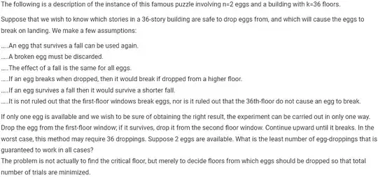

enter image description here In the binomial coefficient solution we construct a function $f(x,n)$, which represents the maximum number of floors we can cover with $x$ trials and $n$ eggs.
