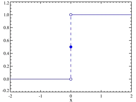

Given a function $f\colon \mathbb R\to\mathbb R$ and a real number $x\in\mathbb R$, we can consider the value of the function at $x$, we can consider the left hand limit of the function as we approach $x$ from below, and we can consider the right hand limit as we approach from above.
For a continuous function, all these three numbers (exist and) are equal. But in general, they can all be different, here is an explicit example:Example of a function whose left and right limits exist and differ from each other and the value of the function. This is a picture of a discontinuous step function. The left hand limit at $x=0$, also denoted $f(0^-)$, is equal to $0$. The value at $0$, denoted $f(0)$, is equal to $\tfrac12$. And the right hand limit, denoted $f(0^+)$, is equal to $1$.
In your definition, the "limit" is actually describing the values of the left and right hand limits, if they are equal - and the limit does not exist, if they are not.
